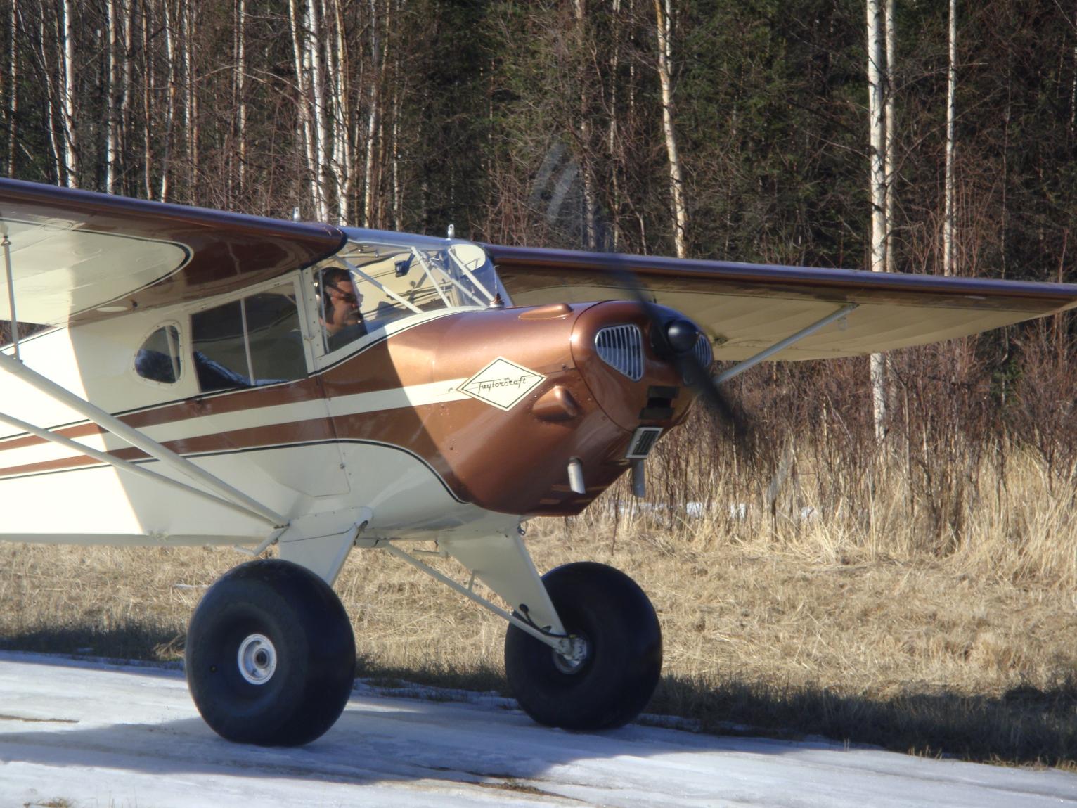

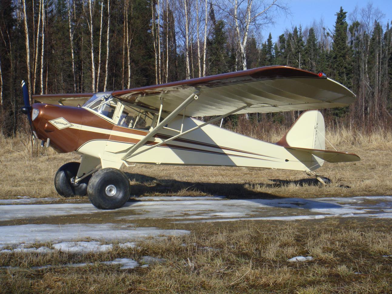

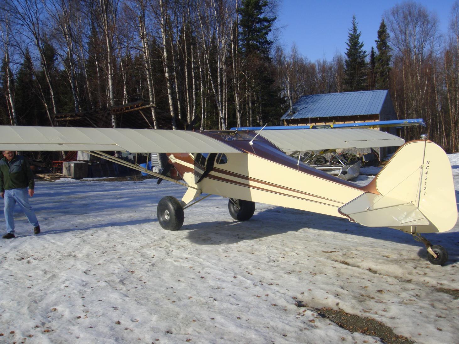

    Thanks all, it really felt great this morning to be flying the old (now new) bird again. Here are a few pics.

                    How do you like those 29s? How's the visibility? I'd love to put those on Miss T someday. She looks great!

                            Visibility over the nose is slightly reduced because of the bushwheels and because I now have the longer engine mount. However, as with any taildragger, you learn to look out the sides while taxiing. On takeoff, the tail comes up quick and the visibility improves. Because of the larger tires, I believe I get more angle-of-attack upon rotation and I believe my ground roll has been reduced. The wing tends to grab a little more lift right at rotation. So far, I'm lovin' it!
