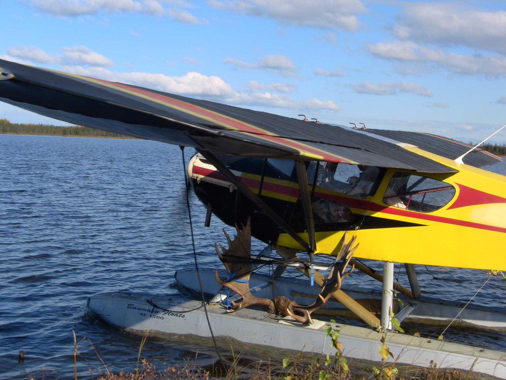

                    I have a 46 Model 19 on the Baumans, they are great along with the price.
                    The 1320's are also approved.
