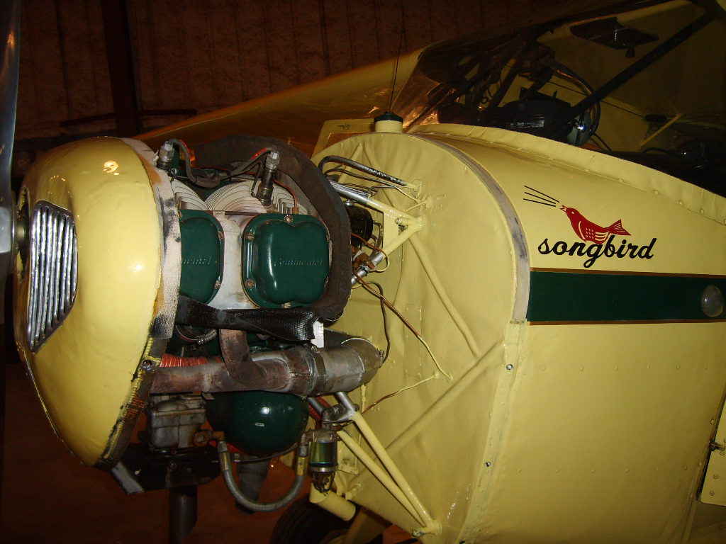

              here is a photo of the cut out on my plane hope this helps

                  I couldn't find a picture of my cowl notch, but it looks just like the one on "Songbird".
