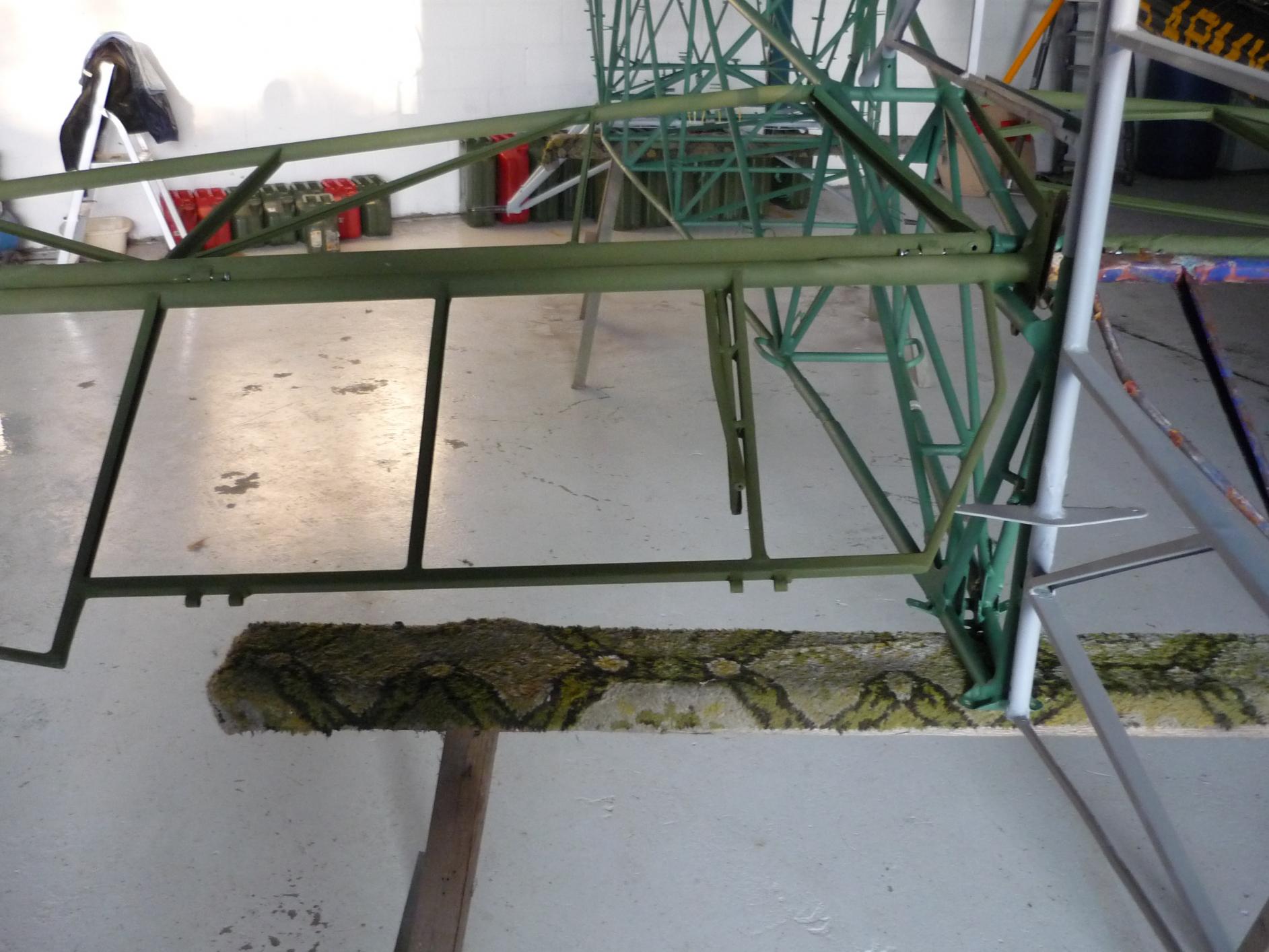

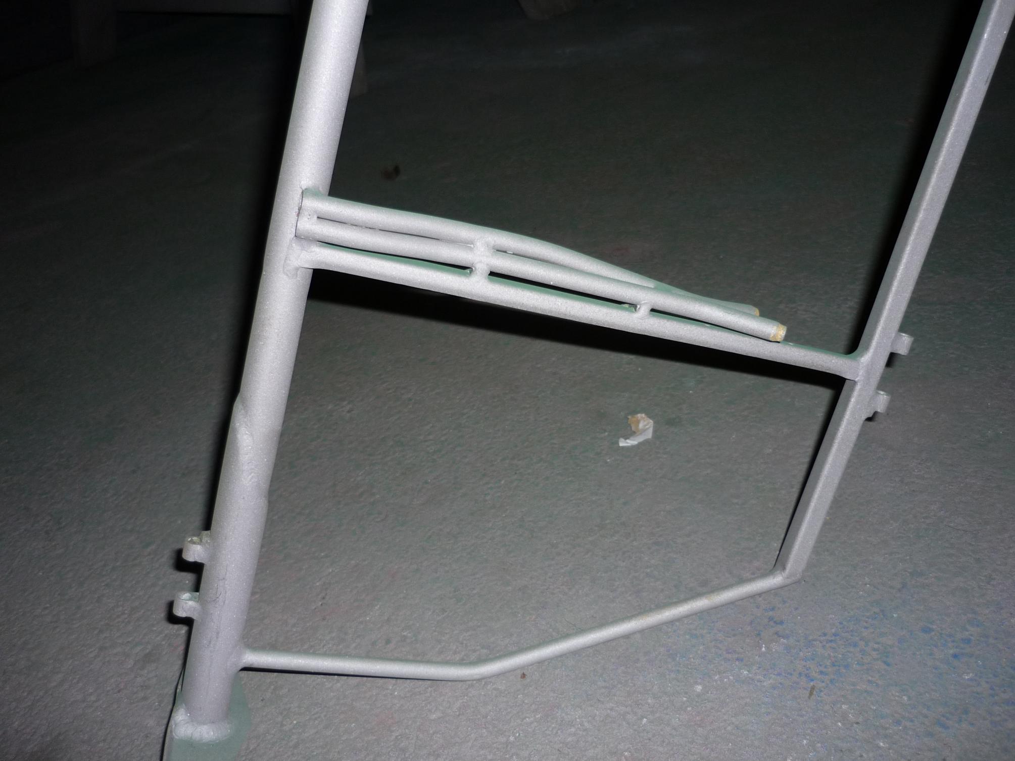

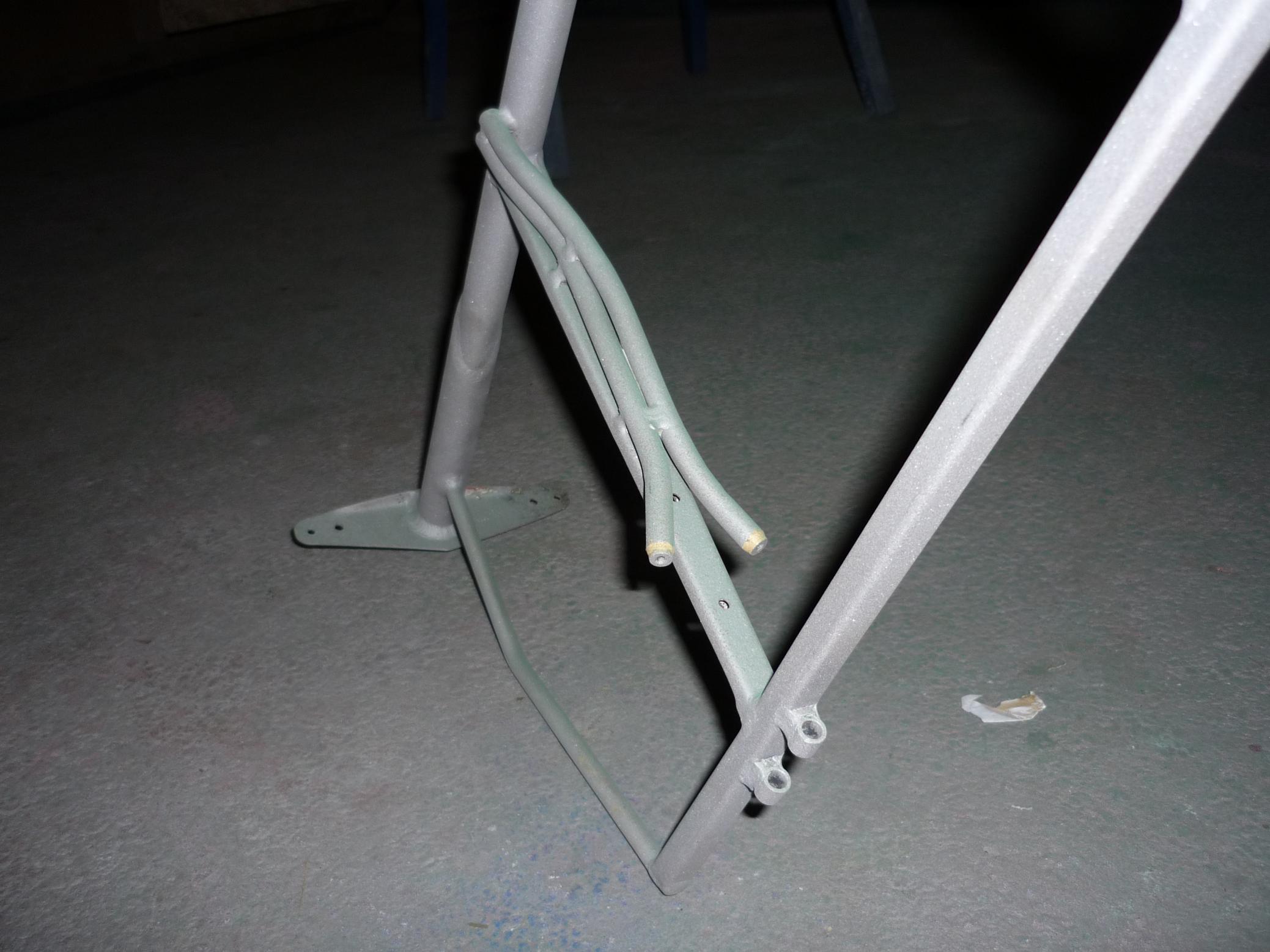

    HI all, am plodding on gradually with the restoration in the UK but have come across something i cannot find anywhere on 'net.
    I have two sets of elevators which seem to have a very early trim system on them with no reference anywhere on how they need to be setup. I've uploaded these two photo's which show what i can't really describe in words. Has anyone got this trim system fitted and/or can supply drawings of how these are to be fitted?
    Many thanks in advance
    Damian
    Re: Elevator trim
    I've not seen it myself, however it looks to me like the predecessor of the screw-trim system which was used on post-1941 models (and some late pre-war models).
    In other words, it has an elevator trim tab, but is operated by two cables using tubes instead of pulleys.
    Similar principle to some earlier brake systems.
    I welcome other folks' input.

      There has been several things on this aircaft that really does lead me to the fact it's older than 1941. Am trying hard to find out more from everywhere i can but to no avail. When i come up next time i'll show you more pics of the items i mean.

        Did the elevators have a sharp turn like that, I thought they were curved. Does that even belong on a T-Craft? Maybe I am looking at it wrong...???
          Re: Elevator trim
          Damian, quite the contrary...that is pre-1941 to my knowledge.
            Re: Elevator trim
            Marty, I am pretty sure it is a T-Craft elevator as i have found on wagaero the wooden trim tab which is the exact same shape i took off, not the mid positioned tab seen on all others around net..
            Damian
              Re: Elevator trim
              Damian,
              It does look strange, kind of neat. Never seen one like that.....
                Re: Elevator trim
                NOT Taylorcraft ; seems to be sort of a copy Auster?? what are u restoring?

                        1939 and earlier models had the winglets below the elevator. There's no jack screw on the LH elevator to adjust the nose up or down travel. Forrest is right. might not be standard to the Tcraft. Look for the pulleys and their routing.

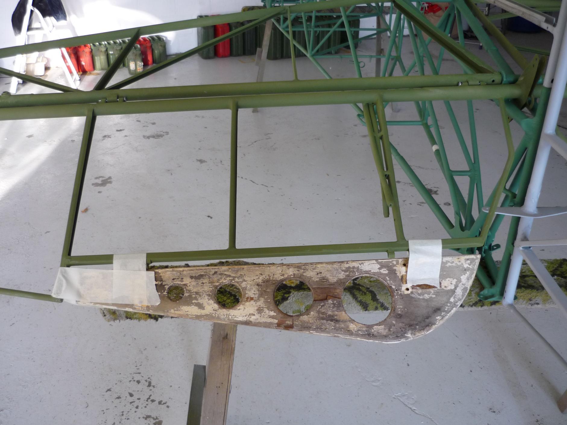

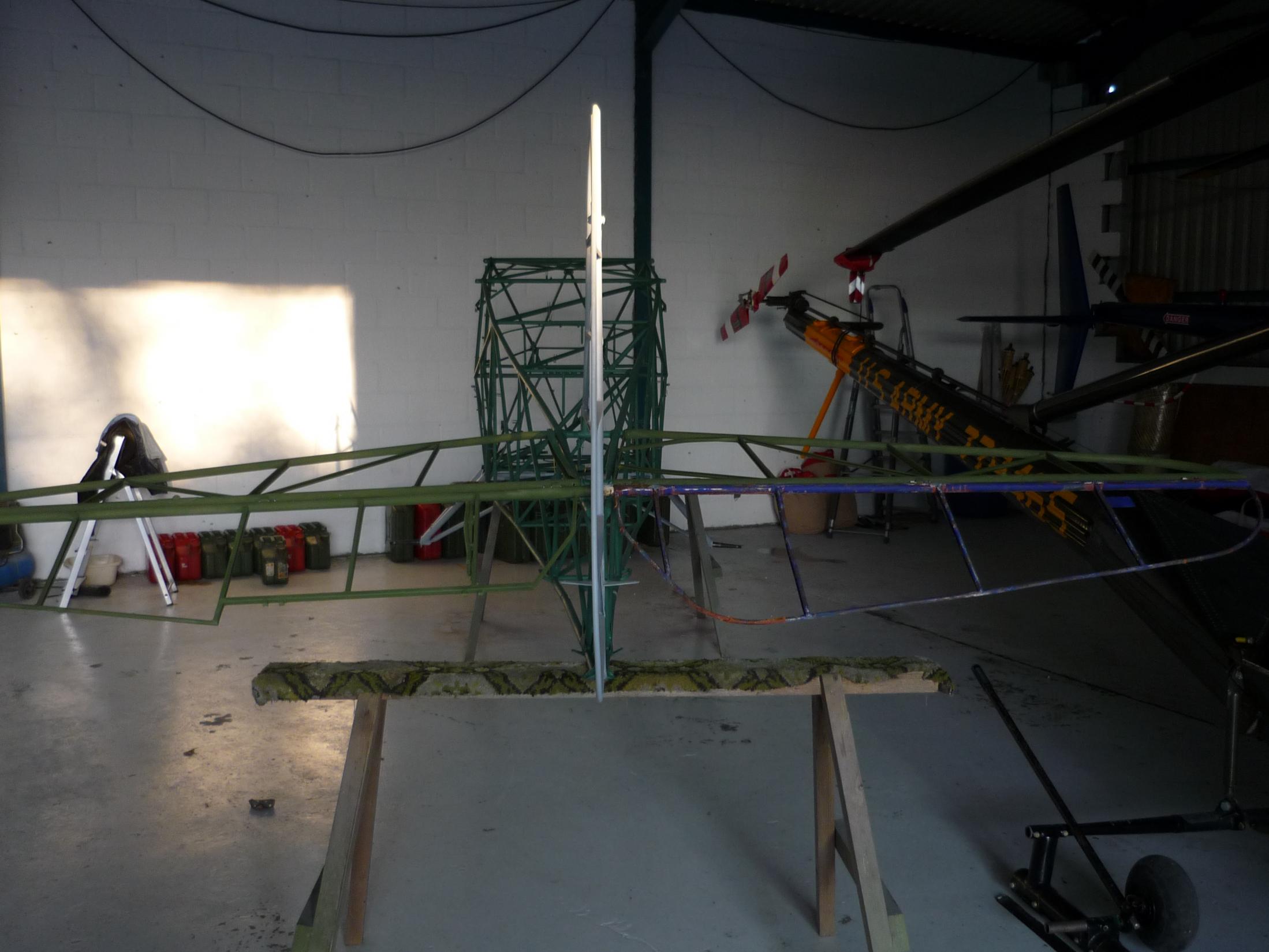

                          Two more pictures after i dry-rigged the tail end today just to see what it looked liked from a different light. Does this ring any bells with anybody???
                          Have taped the old trim tab on one of the pics just to show what i took apart. If nothing shakes anybodys memory then it looks like i'll be trawling net for an elevator for sale!!!!

                            This set up is something like that on Champs. Only the Champs do not have tubes for the cables. The Champ has a set of pullies near the hinge line and another set inside of the fuse to route the cables from the elevator up the left inside of the fuse to the trim handle.
                            Do you see anything like a pulley mounting?
