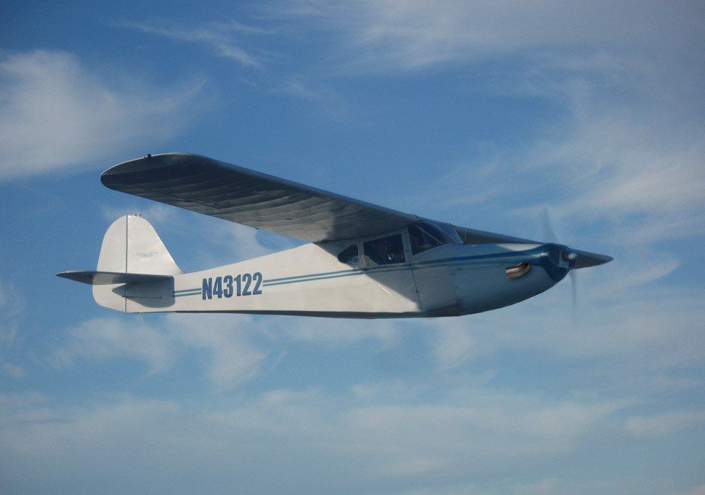

      This is about as clean and powerful you can get on a Tcraft.
      Turbine conversion, cantilever wing, no tail wires, and of course retracts.
      Who will be the first?

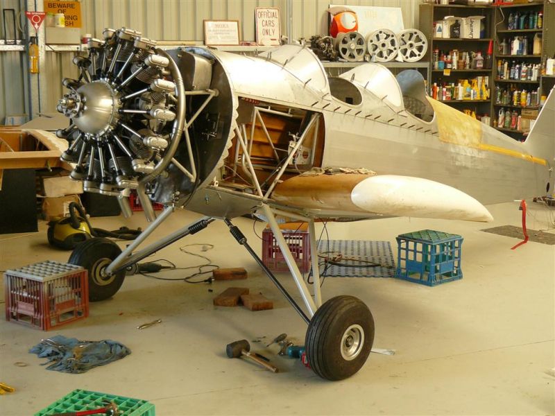

                        This is the type of landing gear suspension I would actually like to put on my L-2. Does anyone have a set of plans for this and could it be done, legally, without converting to experimental? I could still use the original covers so from the outside it would look the same.
