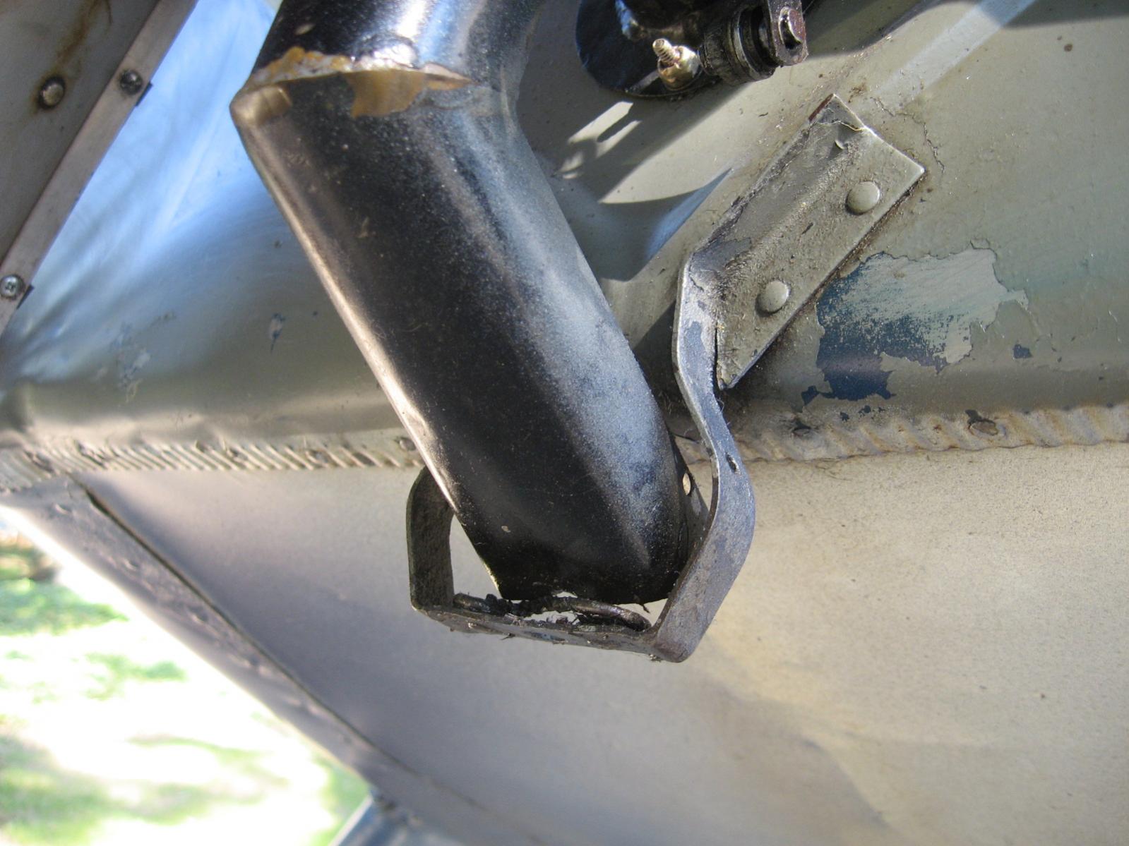

    I'm trying to help Chuck out on a project we are doing and need to find a copy of a diagram that shows the lower front boot cowl brace. It would have mounted to the center Zeus fastener at the bottom of the lower boot cowl and I am not sure where it mounted but Chuck does. Anyway we are missing that brace and would like to remake one for it. If you can help I would very much appreciate it.

    It is a simple strap bent into a flat bottom "U" with the open end riveted to the boot and a Zeus fastener at the bottom to attach the cowl. I just dug through all my photos and not ONE boot photo showed it! If someone else doesn't post a picture I will take one this weekend with some dimensions.

      thank you that would be great the one on 26658 is missing and would like to fix this as the cowl is cracking and the brace will help chuck

        Will do. I'll get some dimensions with the photos.
          Re: lower cowl bracing

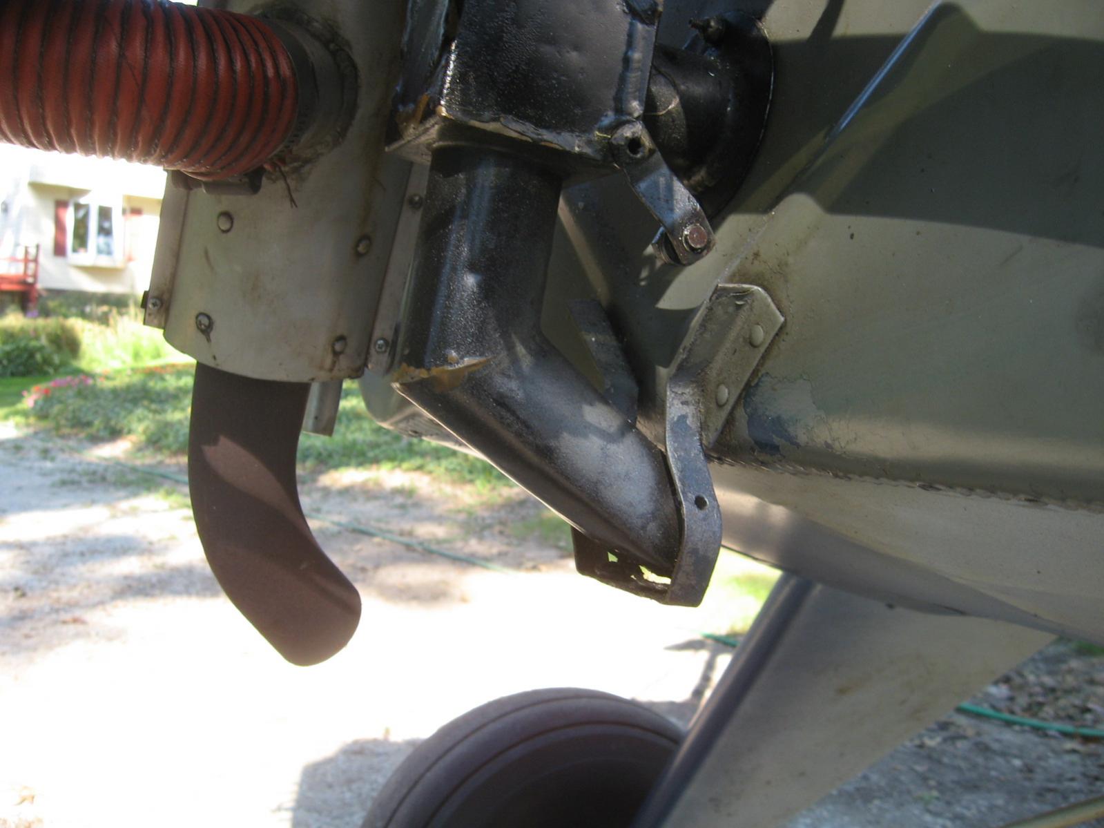

          Taken yesterday. Not sure what year my firewall and boot cowl are...other than not being a 1938 open cowl.

            that is exactly what i am looking for thanks as all ways this site comes through greatly Chuck

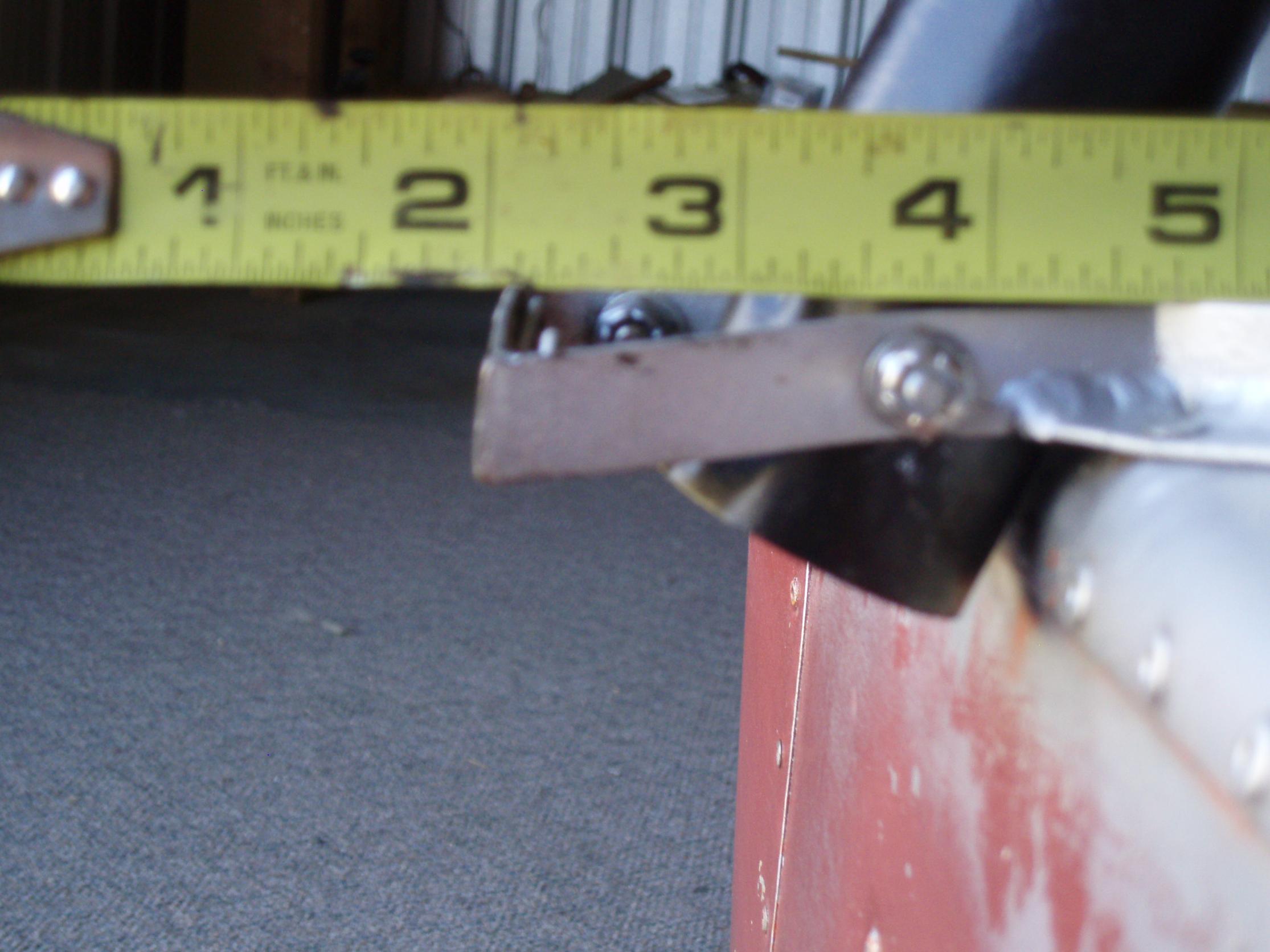

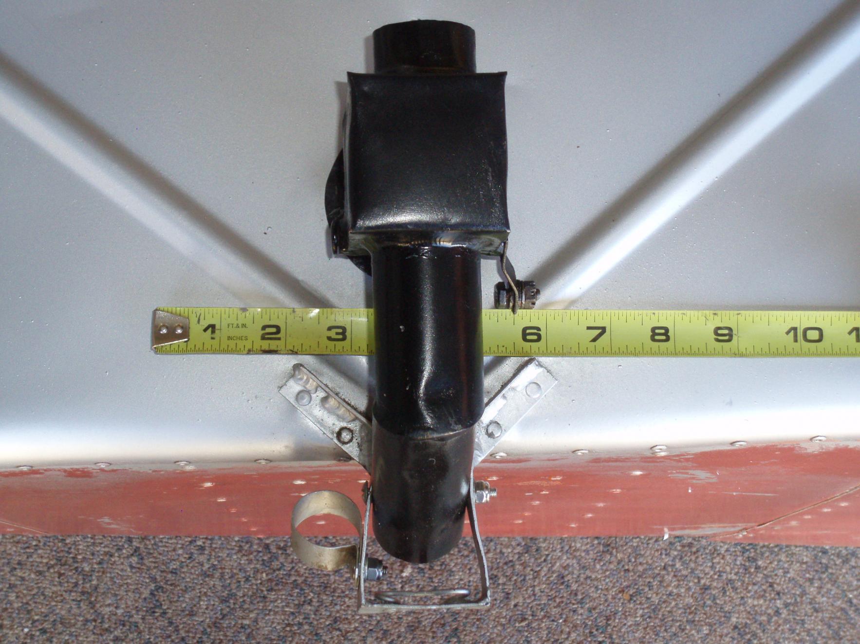

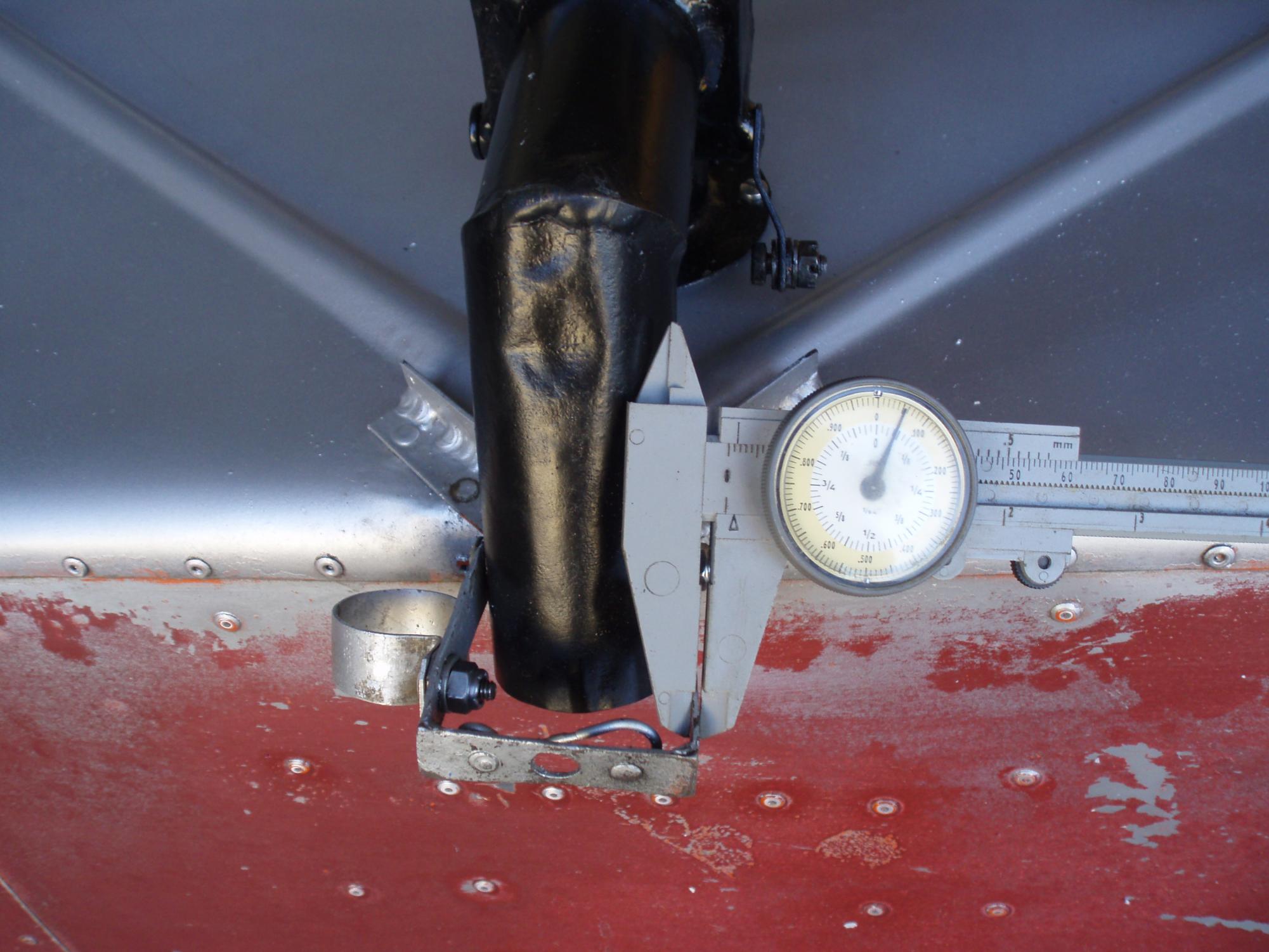

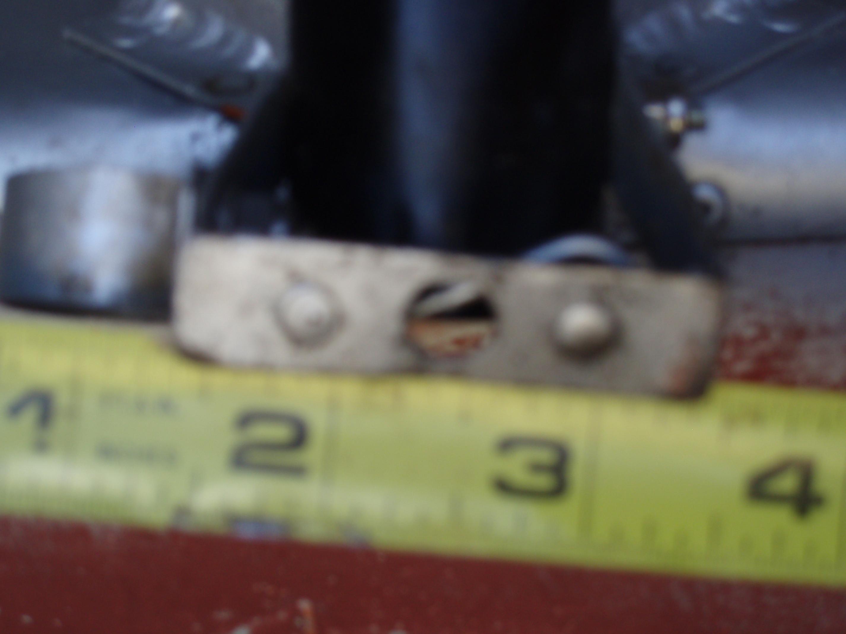

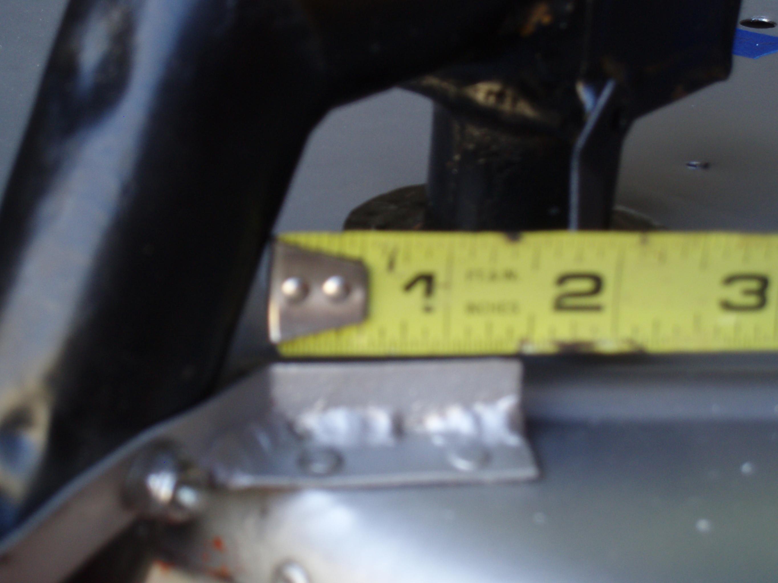

              Got some photos with some dimensions. Hope this helps.
                between Mike and your photos Ray Charles could construct that bracket .Thank you and mike again this site is grate Chuck

                  By the way, the loop on the side is to hold the case breather hose in place. If you make the hose just a bit long it keeps oil off of the belly. If you route the hose up and over the cylinders most of the oil drains back into the case instead of being blown out which also helps a lot. I am putting the elbow mod on my case fitting which should pretty much eliminate oil loss, and my plane hardly uses any oil at all already.
