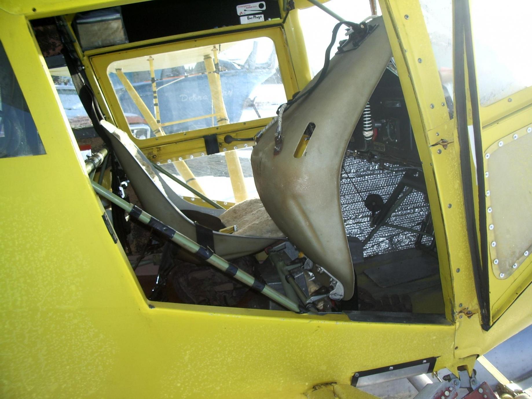

                            I think Dick Smith has fiberglass seats in his....
                            John Click image for larger version

                              Now we're talkin. That's a nice looking setup.
