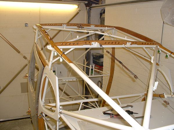

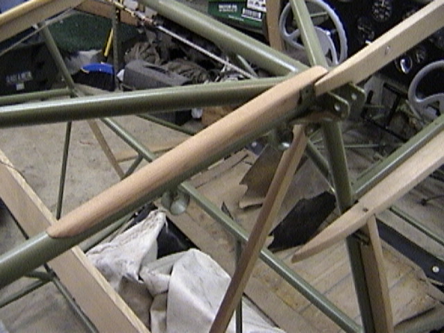

    Does someone have a good link to pics of the wood formers around the top of the cabin? I'm particularly looking for pics of the two small pieces of wood that are behind the rear, lateral former (the one Mr. Clayton provides in his STC); I'm trying to see how the side, rear and the two small pieces intersect; the two side pieces extend about1 1/2" behind the rear former. - Mike

    Re: Pics of how the wood goes around top of cabin?
    Tcartpilot
      Originally posted by tcartpilot View Post
      That's one of my favorites; however, it doesn't show the two pieces I'm looking for - each one is about a foot long and one of the pics shows the back pointy end of one of them; I'm looking for the other end of that pointy piece (don't you love it when we get to talk technical?) - Mike
        That was technical enough it might be beyond me!
        We are talking about the piece that runs along the top of the longeron that fairs the top of the fuse to match the upper wing, right?
        Those pieces were non existent on ours when we took it down for restoration and we build them from scratch.
        We have fabric on our fuse already but no windshield or interior yet. I will try and get some better pics of that area tomorrow.
        Tcart
          Not the best quality pic, but I think this is what you are referring to.
              THAT's IT
              however, your pic is missing the cross piece that apparently also joins the two pieces shown; I'm going to assume all three must flow together.

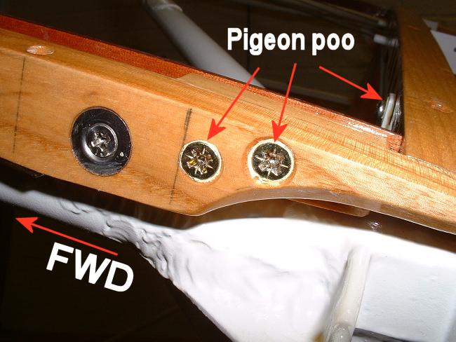

                  The only photos I could find are these.
                  The first photo shows the port former (above the door) intersecting with the rear skylight former over the rear wing attach bracket.
