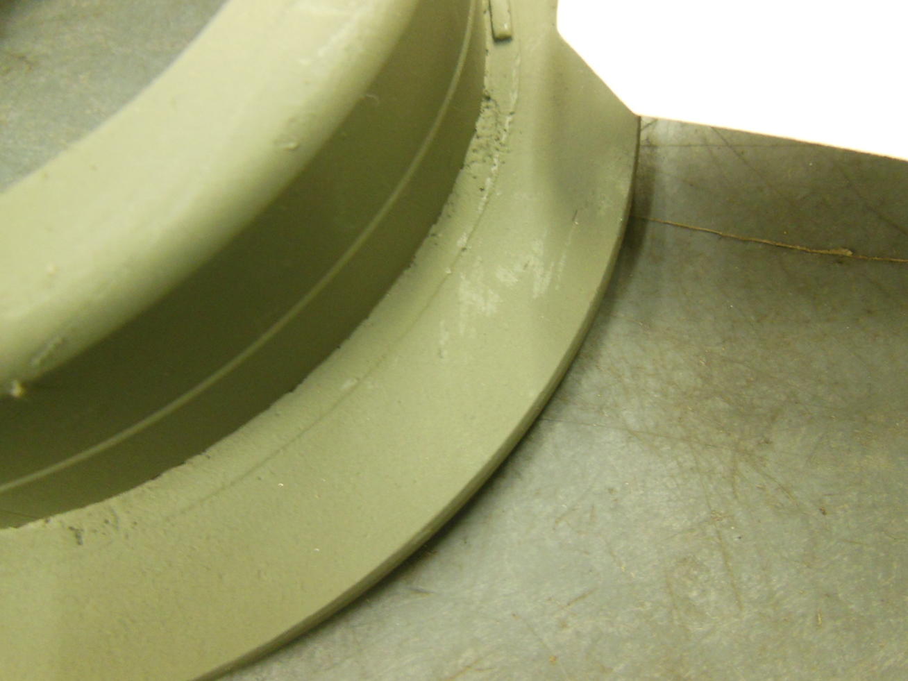

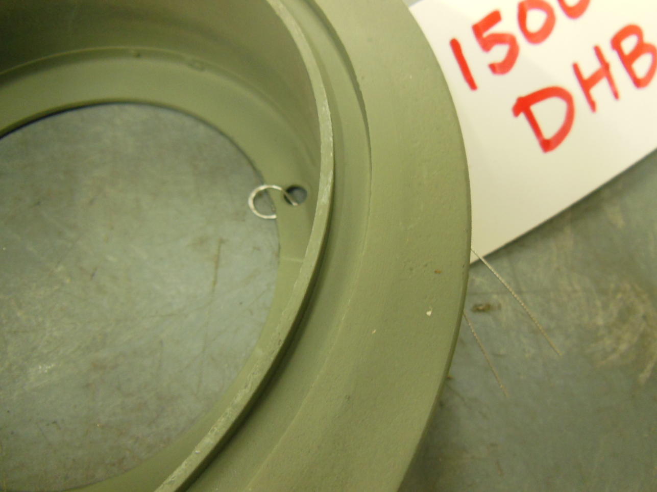

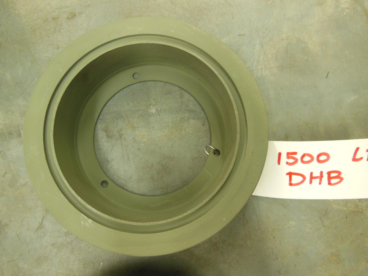

                          Look at the drums and I bet you discover that the hoops/heat-sinks are not installed thereby allowing the drums to expand.
                          Those drums have only about a .060" wall thickness.
                          Dave R.
                          p.s. will try to post a picture of the hoop/heat-sinks
                            Hi Dave.....are hoops/heat sinks the rim items that appear to be discs for disc brakes? It would then seem your plan would be the best and cost effective. Could an external banding plus heat reform the drum? Or is it once deformed that's the end game?
                              Yes, the hoops/heat-sinks are the items that appear to be in the same position as one would expect the rotor for disc brakes to be.
                              However the hoop/heat-sink is made of aluminum and is slid over/around the drum starting from the end of the drum with the bolt holes.
                              You would slide the hoop/heat-sink off of the old drum and install on the new. It's a light drive fit.
                              As I said you can buy the drum made from discs for about $200-$225 or buy the discs and make your own. I sell the disks for $85 on ebay.
                              If that drum is warped I don't think that I could get it back in shape and I bet I would charge as much or more than buying or making a "new" one.
