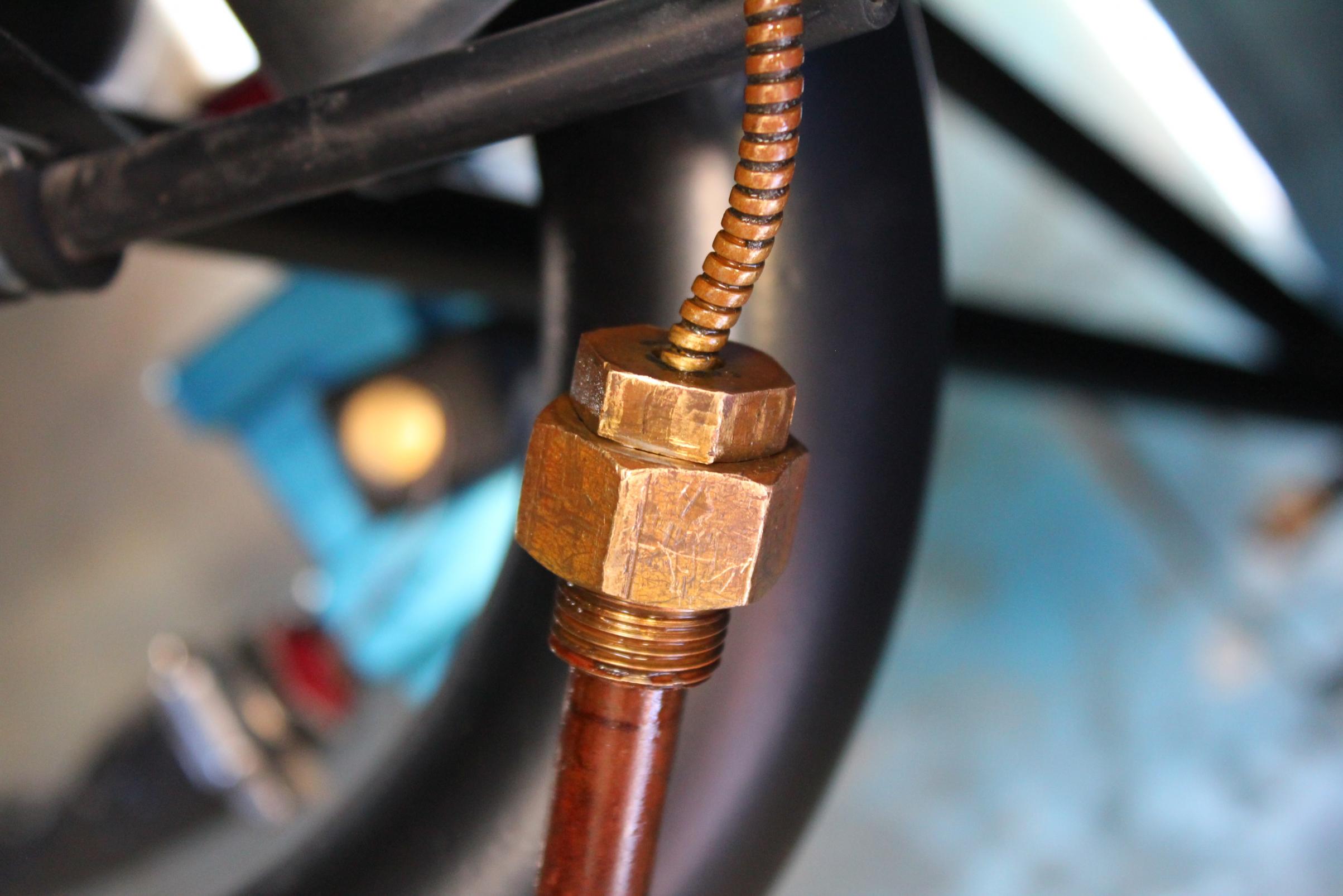

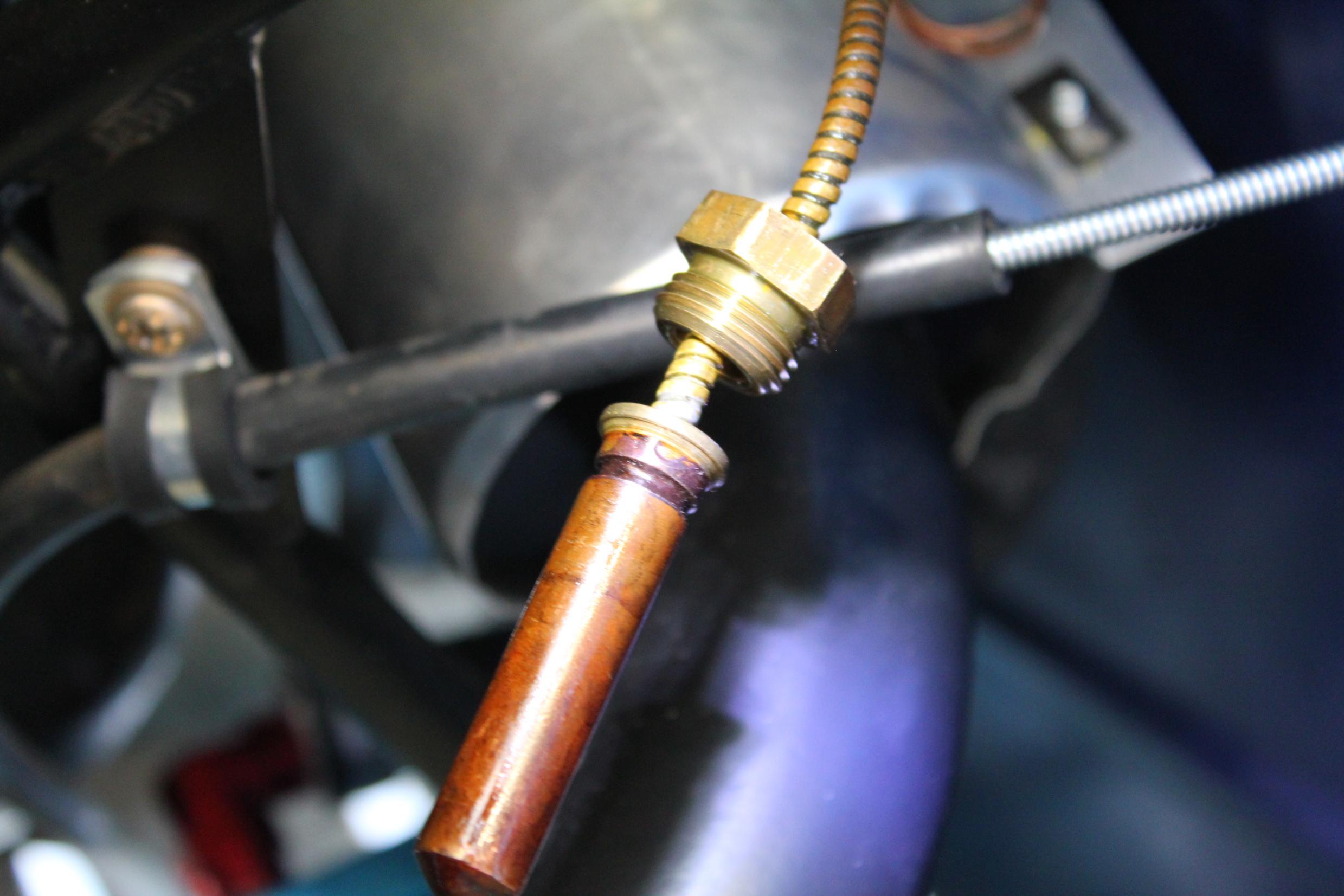

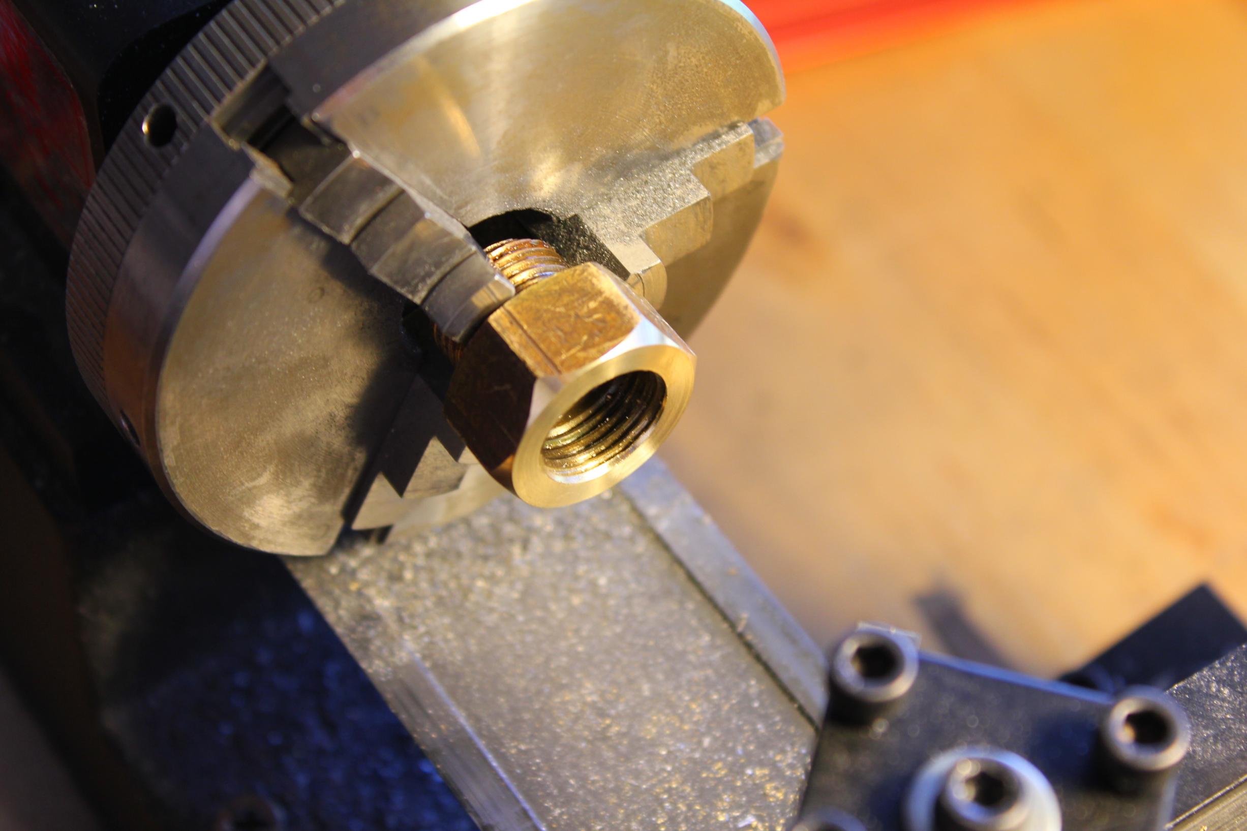

                  problem solved - I hope
                  I believe I found the cause.
                  My parts match up in terms of having all tapered bulb flange pieces so that doesn't appear to be the cause.
                  What I did notice is that over the years of tightening that bulb fitting nut it has slowly compressed the sealing flange to the point now where the bulb nut bottoms out on the adapter before it has had a chance to contact the sealing surface of the bulb.
                  So I've taken the adapter nut off and turned it down about .050" on my lathe. This should allow the bulb nut to turn at least another full turn if needed and compress and seal the bulb flange against the adapter.
                  the pics may help with understanding.

                    Re: oil leak from oil temp fitting
                    Or perhaps install an AN900 washer??!! :rolleyes2:
                      no, that would be the opposite of what I need to accomplish. I need to shorten the adapter nut face. Adding a washer would lengthen it.
                      DJ Vegh
                      www.azchoppercam.com
                      www.aerialsphere.com
                      Mesa, AZ
                        oil leak issue appears solved. Turning down the adapter nut face allowed me to turn the bulb fitting nut an extra full turn which caused the bulb sealing surface to be properly pressed against the adapter nut.
