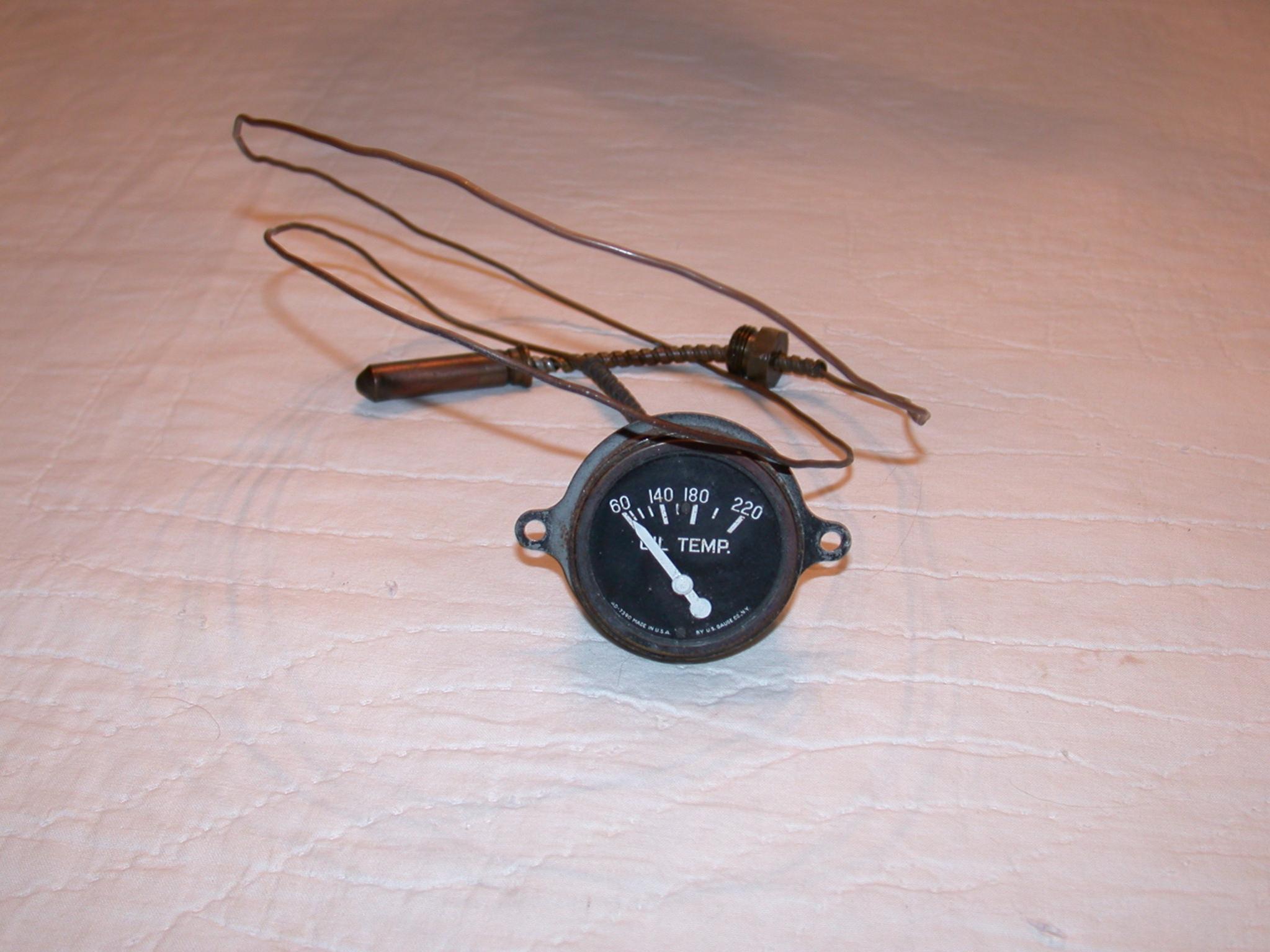

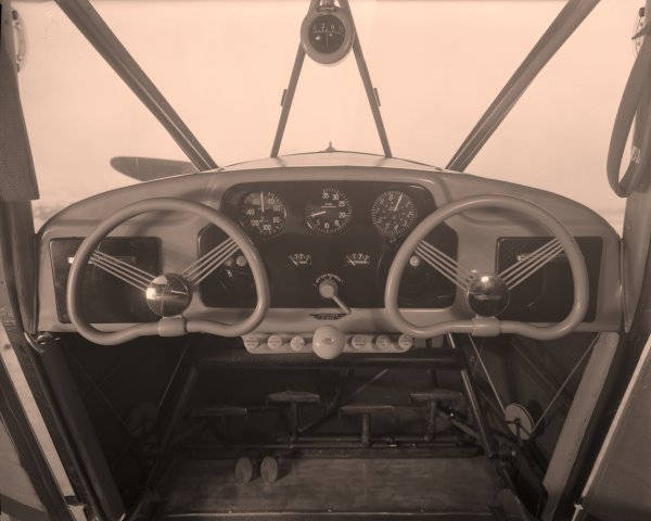

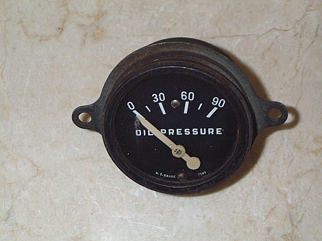

    If you find any extra bulb Oil Temps please let me know. I have been looking for a couple of years. Here is what you are looking for. They are made by U.S. Gauge instrument company.
    You "can" keep flying with a Smiths gauge, but it doesn't look the same. If you have a post war panel where the whole gauge face is exposed, there is also supposed to be a Taylorcraft logo on the face of the instrument (the 41 has a mask over most of the face of the instrument and no logo).

              I got dibs on the next one. Be prepared. I was quoted $300 to put a new bulb and line on a U.S. Gauge Oil Temp! That is more than a working gauge usually sells for! That means the core isn't worth much.
              The oil pressures are a lot cheaper to fix. Treat those temperature bulb lines like they are glass! You are spending $300 when you hear that soft HISSSSSS.
              Another thing, make VERY SURE you are screwing the bulb in with the right hardware!!! There are bulbs that go into a flat base hole and ones that go into a tapered hole. Put the bulb in the wrong hole and it will leak. Tighten the nut to stop the leak, and you break the line! HISSSSS!
              Anybody know a less expensive repair? That would raise the value of the cores. Maybe we could figure a way to put different guts inside a broken U.S. Gauge case.

                    I think you mean that price for the Oil Pressure (close to the price I heard). There is no bulb on a pressure gauge. The oil Temp gauge has a long copper or soft brass line to a bulb that attaches to the engine case. The line and bulb are filled with a gas that expands when heated to move the indicator. Problem is if there is even a tiny hole the gas escapes and the gauge stops working. That's why they are so hard to repair.
                    The Oil Pressure gauge has a threaded fitting on the back and just hooks to a line to read pressure with a Bourdon Tube (a coiled tube that tries to straighten when it is pressurized). Much easier to repair.
                    If they can actually fix an Oil Temp fro that price I REALLY need a broken Oil Temp!
