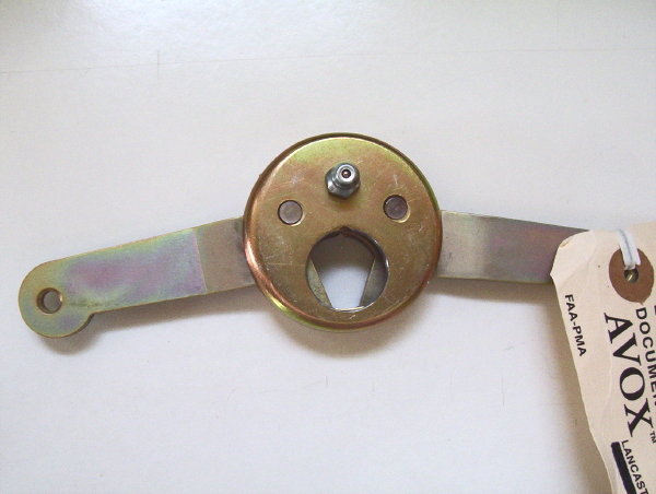

Here is a pic of a new Scott (Avox) steering arm. The surface that contacts the yoke shaft are perfectly straight. I didn't get a picture of the shaft but a new shaft is machined straight also with no break on the edges. The steel in the steering arms is relatively soft so it takes the majority of the wear.

Thank you for sharing this. It will be of great value in getting the arms to the correct shape.

1. The dowels that hold the unit together are at a length that will be flush with the surface when burred. To remove the dowels I drilled enough to remove the burr on each.
2. A local welding shop built up the arms that allowed me to reshape them to the original design using my old tracings along with the use of the excellent photo of the new arm assembly that was provided.
3. It should be noted that there are 3 flat circular shims/spacers made of brass. one is situated between the arms and one inside each "cap" assembly.
4. I located the proper dowels at our local hardware store but they needed to be ground to the correct length to assure they were flush with the surface after burring. The dowel holes in the cap are very slightly countersunk to allow the slight burring of the dowels and allowing them to be flush with the surface.
5. My old arm did not have a grease fitting. I added one using a #3 drill and a 1/4-28 Zerk fitting.
The unit appears to be restored to the original functioning condition and I offer the above in case there are some out there that needs to consider a rebuild rather than spending big $ for a new one. BTW, I ordered a new arm from Univair at a cost of $333.00.
