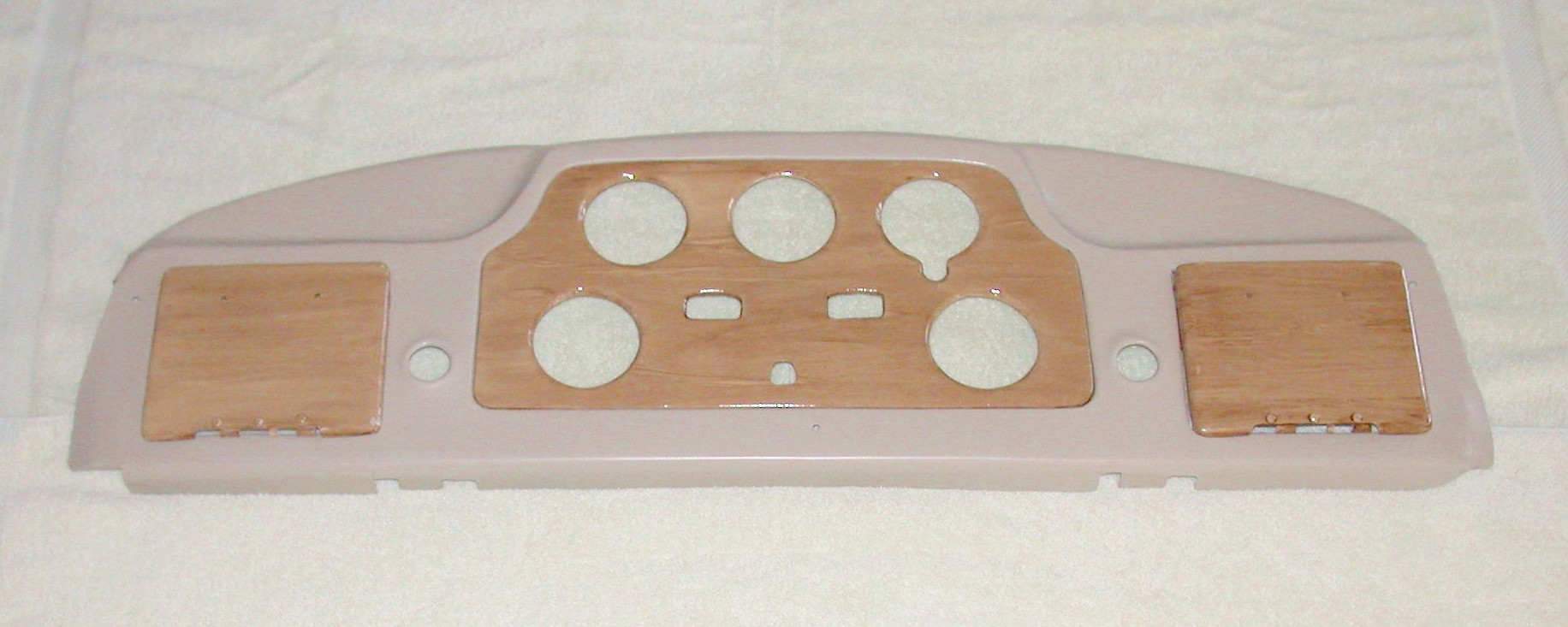

                Hammering onto a Bondo buck is not that hard. Just use SOFT aluminum and go SLOWLY. When we say it will take a day, it takes A DAY. Rush it with hard blows and you will harden and tear the aluminum, crack the buck and convince yourself only a master metal worker could do it. NOT TRUE! With patience and a soft touch you can make almost anything from a flat sheet.
                It took a couple of tries to make my panel, but it was done from a flat sheet of aluminum, a leather shot bag, an MDF form and a few plastic hammers. IT ISN'T THAT HARD!

                      I made the instrument panel parts on three male bucks, I guess. The main panel had the top corner areas recessed, so I guess you could call that a female buck part on a male buck.
                      I have used male and female bucks, depends on what you want to do.
