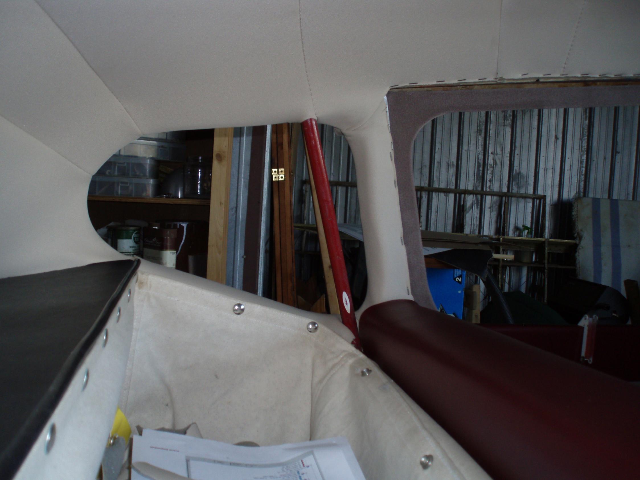

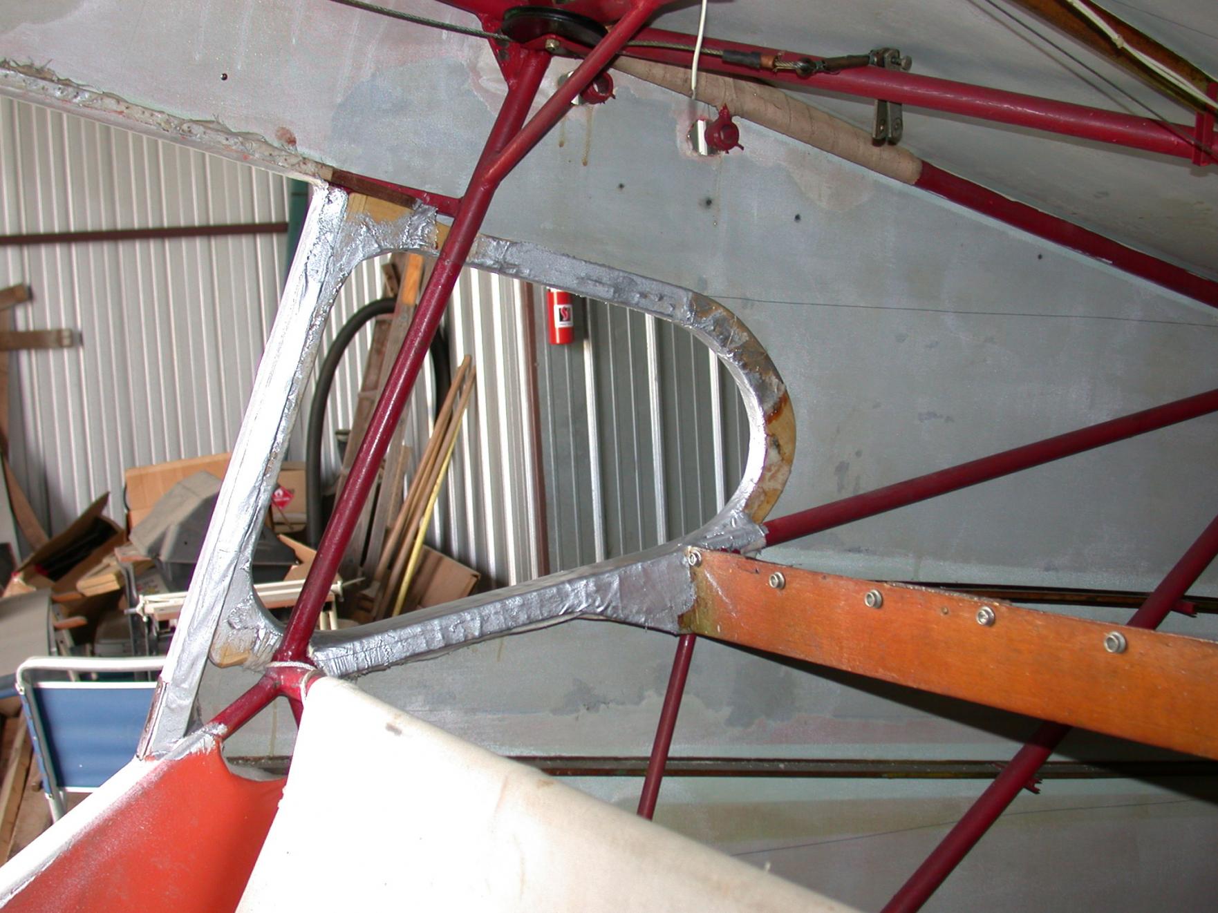

      Are we talking baggage sling or seat sling? I think the question was for the baggage sling where there are two short pieces of wood going back from the upper seat back tube (with the wood cross piece Tom was talking about). These pieces of wood are attached to the baggage sling rear wood piece with some metal angle clips. There should also be a wood frame behind the cross piece that support the hat shelf and the aft edge is where you attach the headliner.
      In the picture the short piece is under the fabric below the "D" window and the long piece is on the left of the sling. The piece of wood Tom was talking about is on the right or the sling. To the left of the top of the sling you can see the hat shelf.

        Found this earlier picture with the headliner out.

          Like Hank's pictures show. 2 short pieces on the sides extending back from the top of the seat, and a cross piece at the rear. The sling attaches on the sides and the rear to the wood. The front should go over the the top of the seat sling and be stiched or glued.

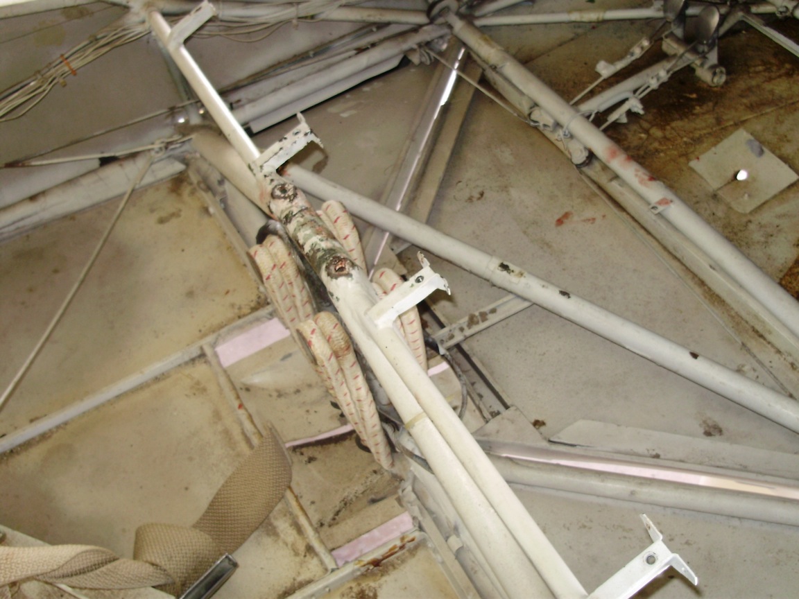

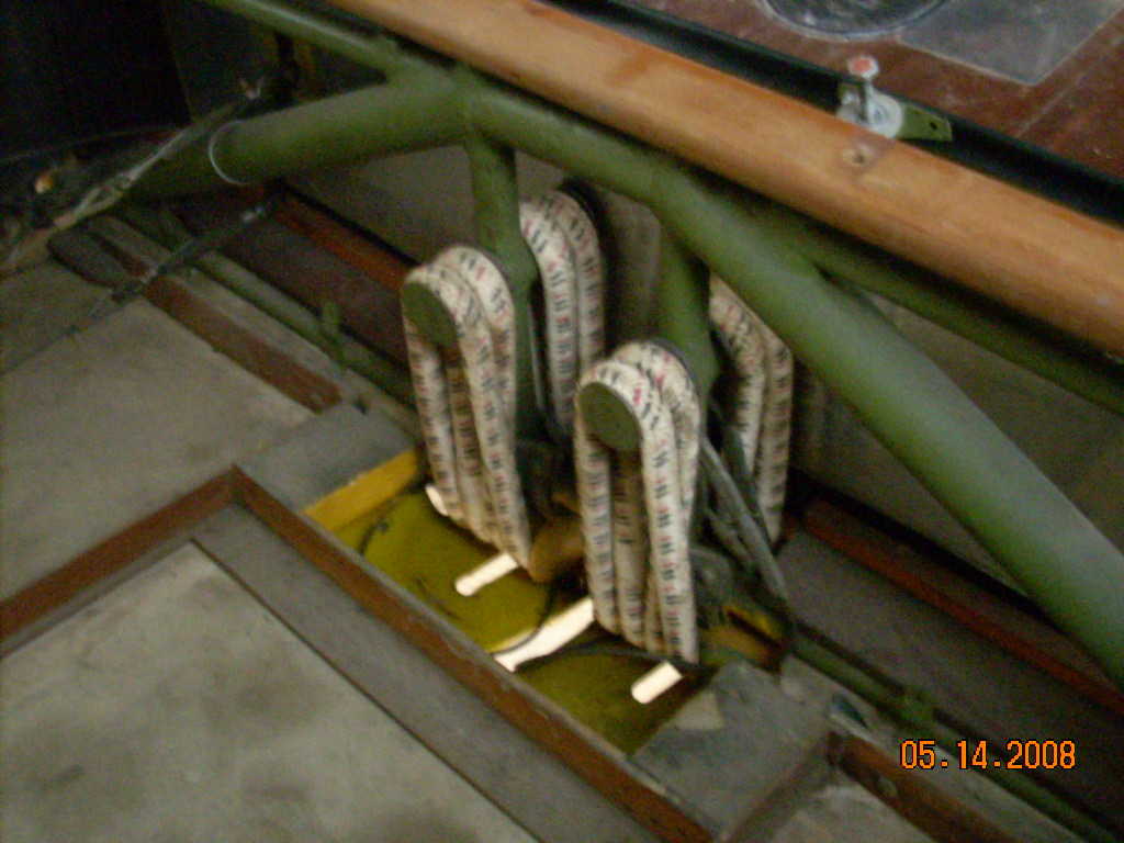

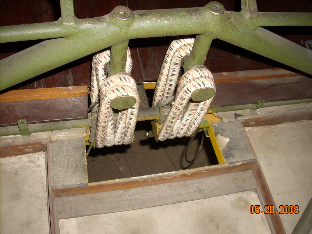

            Would either of you happen to have some pictures of the wooden cross member that picks up the bottom strangers and forms the opening around the bungee cards. None of these parts were with the aircraft, and I'm having a problem with the shape of the cross member at the gear attachment point. There are a lot of pictures of the bungee cord opening but none show the area under the frame at the gear attachment point. Thanks Rex

                Here is a photo you might could use...

                  Hi Rex, Here are a couple of shots on the '39. h

                    Thanks Everyone, I thank I now understand both the baggage and frame work around the bungee cards. Its nice to have a group of knowledgeable people to ask questions.

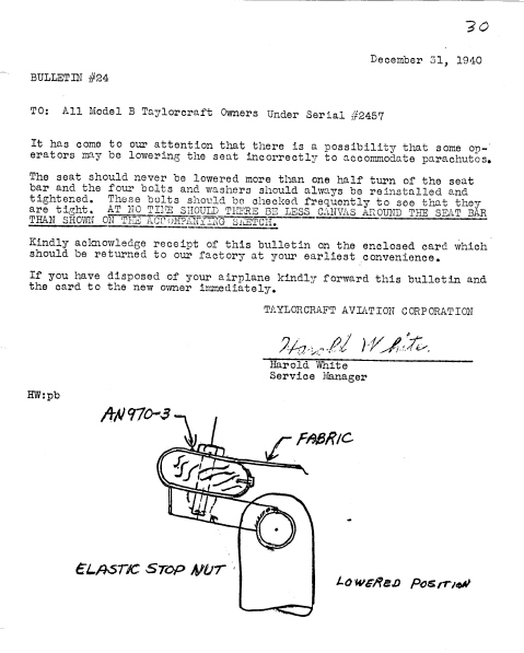

                            Hi Bill,
                            Don't know if you've seen this. But look at the nut they reference in the S.B. 24 dwg. This is the way mine are in the '39. No threads in the tubes.... h

                              Yes, Howard,
                              I'd seen it here but have been looking all over and was unable to find it. (Ed.: I referred to it as an AD by mistake. Meant SB.)
                              My new computer doesn't like my old printer so I had carefully copied it by hand and filed it with my a/c logs. But I am saving this to disk for future ref.
                              Thanks!
