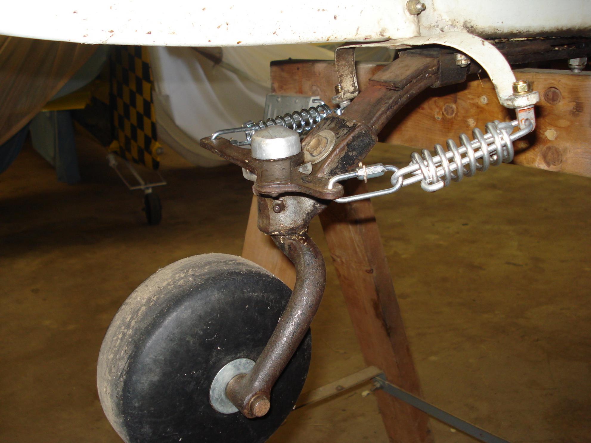

    Tim he must have had larger holes in the tailwheel arms. I had the original tailwheel which was not full swivel and i could not get the springs thru the holes in mine. Marv

          Here is what my tailwheel setup looks like now. Thanks to everyone who helped with suggestions. Using the eyehooks allowed me to leave out one of the supplied connecting links. There is a little backlash on the left and the right, so I think that it's about right. I haven't taxiied it yet.
