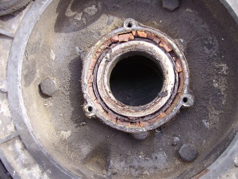

There is no telling how long this nose wheel bearing has been without new grease. My guess is at least 5 years. It is a PITA to get to the bearing when there are wheel pants on the plane, so guess what? Owners beware.

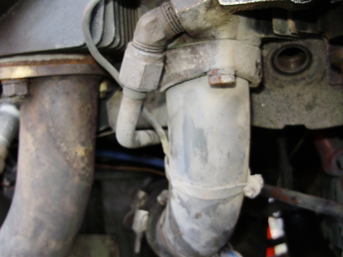

The characteristic grey/brown exhaust stain on the forward exhaust tube spells trouble. This leak has been going on a long time judging by its size. The cylinder's exhaust port is eroded very badly. The alternator is covered in corrosive deposits. Part of the cowling brace structure has been burned through, and this plane was a candidate for a severe inflight fire.
