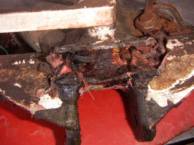

                  The "seaplane" on floats was an "experimental" certification and had nothing to do with the strut inspection . That was the reason for the "attach fitting" inspection. See photo , if yours looks like that , don't fly it!

                    The strut AD came about following the Factory SB, which was issued before the accident.
                    What followed the accident was the fitting AD.
                    The two are not related in other than timescale.
