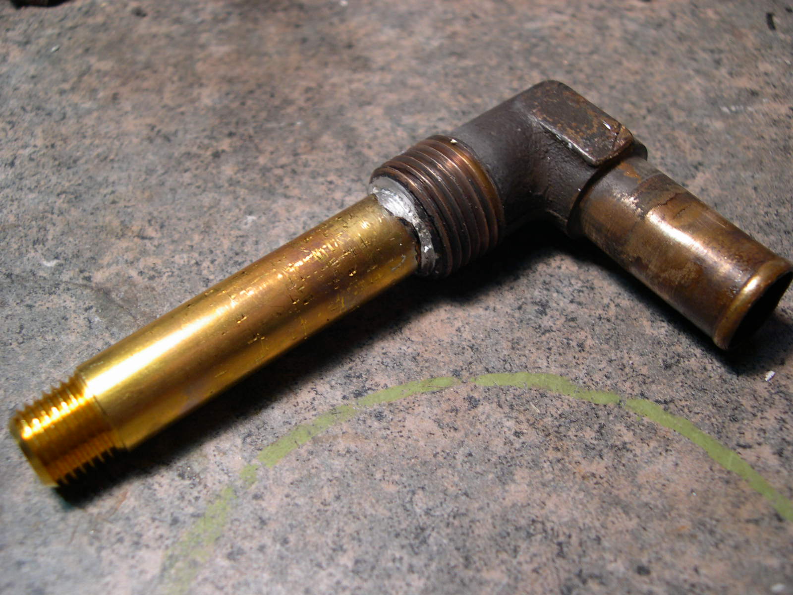

        I'm reluctant to post this picture because someone might think they can just go to Menard's and buy a 1/4" x 3" brass nipple for $2 and solder it into the breather fitting instead of buying the $300 Continental part noted in the 120/140 link above. Someone might be tempted to use the $2 nipple, it fits perfectly and costs 15,000% less than the breather fix part from Continental. But, NO!, don't do it!

          Re: Breather Modification
          Originally posted by mulwyk View Post
          Someone might be tempted ... But, NO!, don't do it!
          Yeah, at least cut the threads off the end...
