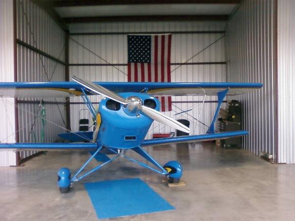

              $600 per month!!! OUCH!! We just had a new airport go in 20 miles away and they have 14 brand new condo style t-hangars with paid electric,running water,and bi-fold doors. The apron has several nice airplanes tied outside because they simply think it's insane to pay $150 per month for hangar rent, I think they have 5 or 6 of them rented and the rest are empty(my cousin has one of them). Here at West Liberty if you want to build your own all you have to do is sign a 20 year lease on the ground for $20 bucks a month and when the lease runs out you either renew it or you can donate it to the airport for a complete tax exempt rightoff. You can donate it at anytime during the lease also. Most other airports in the area have the same standards. If you rent an enclosed t-hangar in central or east Ky expect to pay between $50-125 per month depending on how close you are to the larger cities and how commercialized the airport is or is trying to become.
              Here's a pic of my cousins $150 per month hangar.
