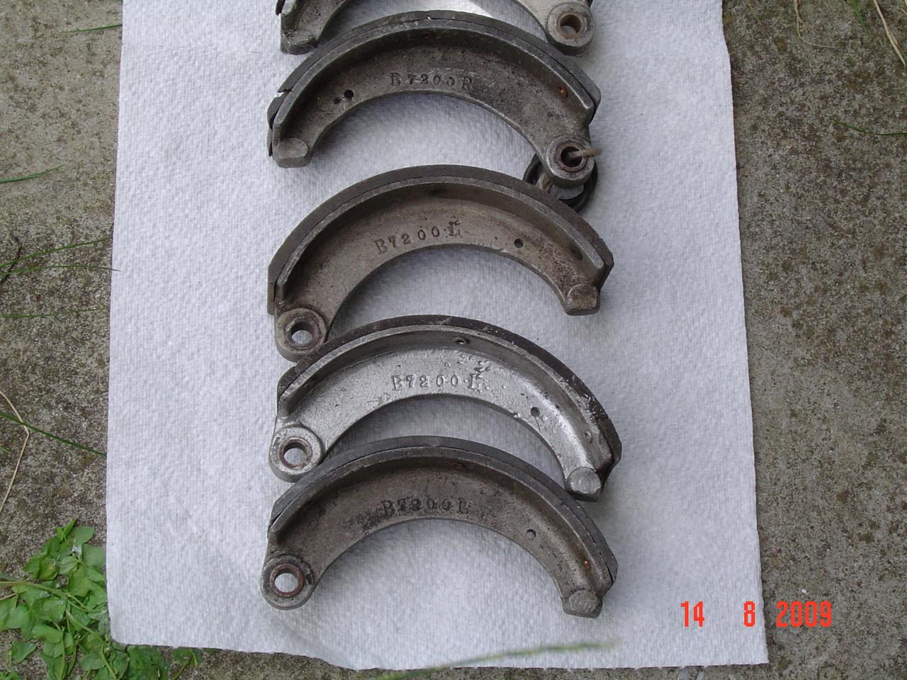

B7000L,R brake shoes
  • B7000L,R brake shoes
    Not from a Taylorcraft, probably, but can anyone identify from which aircraft / brake these brake shoes might be?

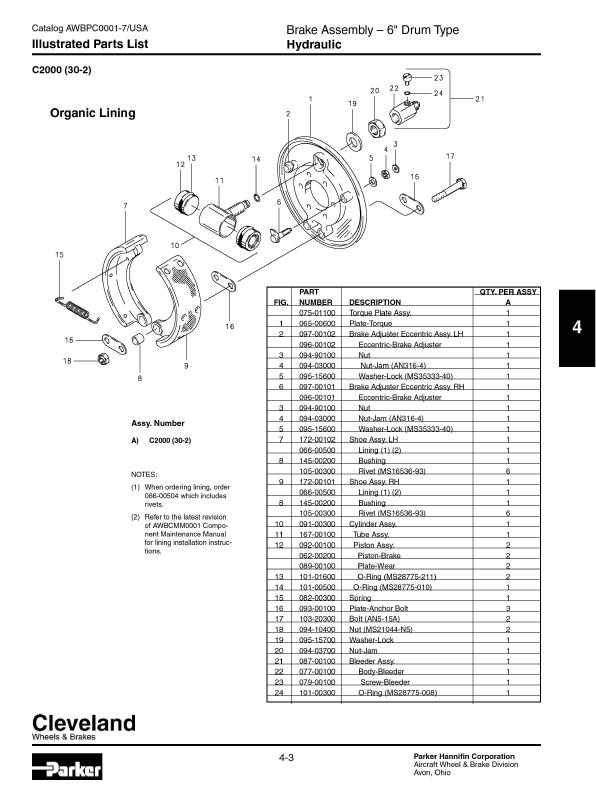

    Hey Rob,
    Those look like Cleveland hydraulic brake shoes. They were used mostly on Tri-Pacers and some Aeroncas. I've attached the appropriate page from the Cleveland catalog showing the brake assembly.

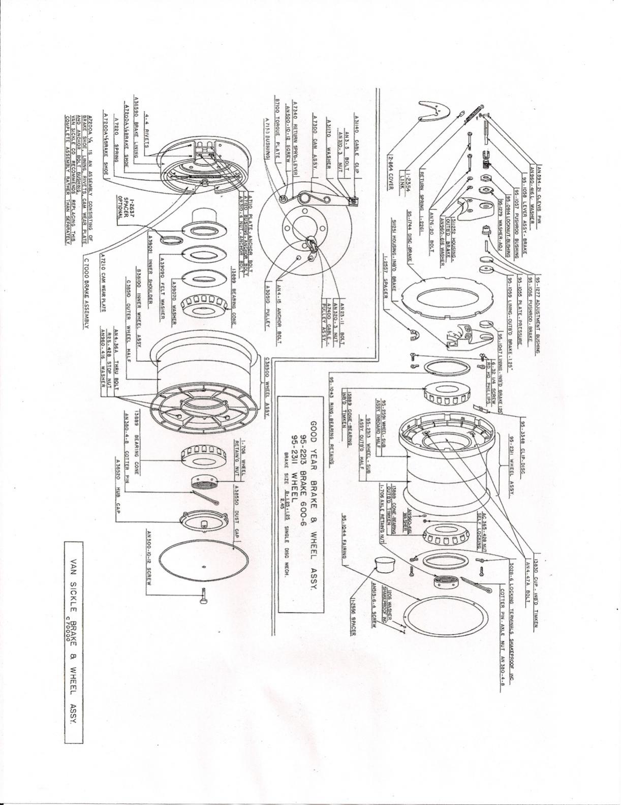

        Re: B7000L,R brake shoes
        Yep, Cleveland wheel, formerly Van Sickel wheel.

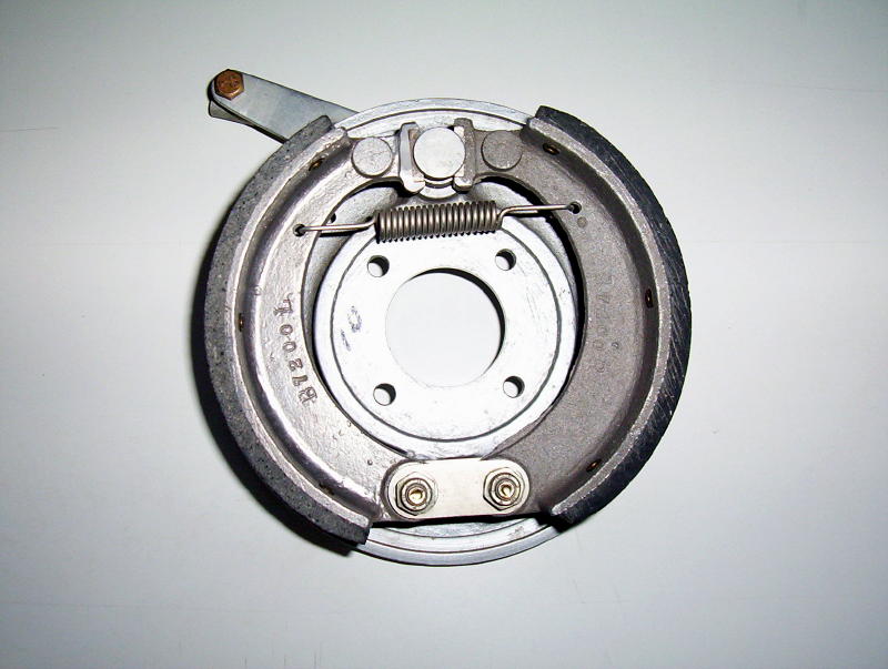

        Attached page from Aeronca Service manual shows Goodyear and Van Sickel wheels as options on the Aeronca 7AC.
          Hey Mark and KRW,
          The shoes are from a Cleveland wheel/brake but they are not from a mechanical brake assembly. The part of the shoe that bears on either the cam (mechanical brake) or the hydraulic cylinder (hydraulic brake) is different for each application. The shoes are not interchangeable between mechanical and hydraulic assemblies.
          Dan
            AhHa!
            Good information Dan. I see the subtle difference between the hydraulic brake drawing posted by KRW and the mechanical brake drawing I posted.
