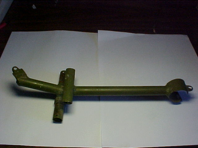

        Hmmm perhaps the clamp on's would work too! I now have acquired the pulleys and bushings. They are offered on the F-19 under the TC. OR just copy and weld in...

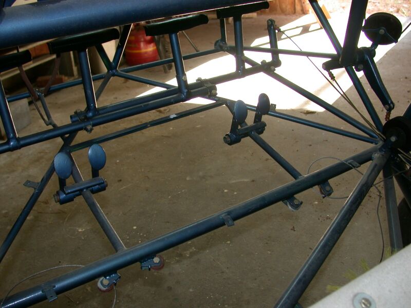

          Ran into an interesting problem. I fabricated the main tube with the bend, tacked the pedal support in place, placed a pedal on the support and clamped it into place. Now, one would think the brakes would be symmetrical, i.e. the pilot side brakes and the pax brakes would be the same distance from the centerline; however, if you do that, the right pax pedal will not cover the same arc before striking a diagonal member! To maintain the position of the main tube and gain more pedal arc, I'm going to have to move the pedal support aft about an inch. If anyone has their pax brake exposed, could you see if those pedals are about an inch further aft than the pilot side? If they aren't, I'll have to come up with a scheme for moving the main tube closer to the a/c centerline. - MikeH.

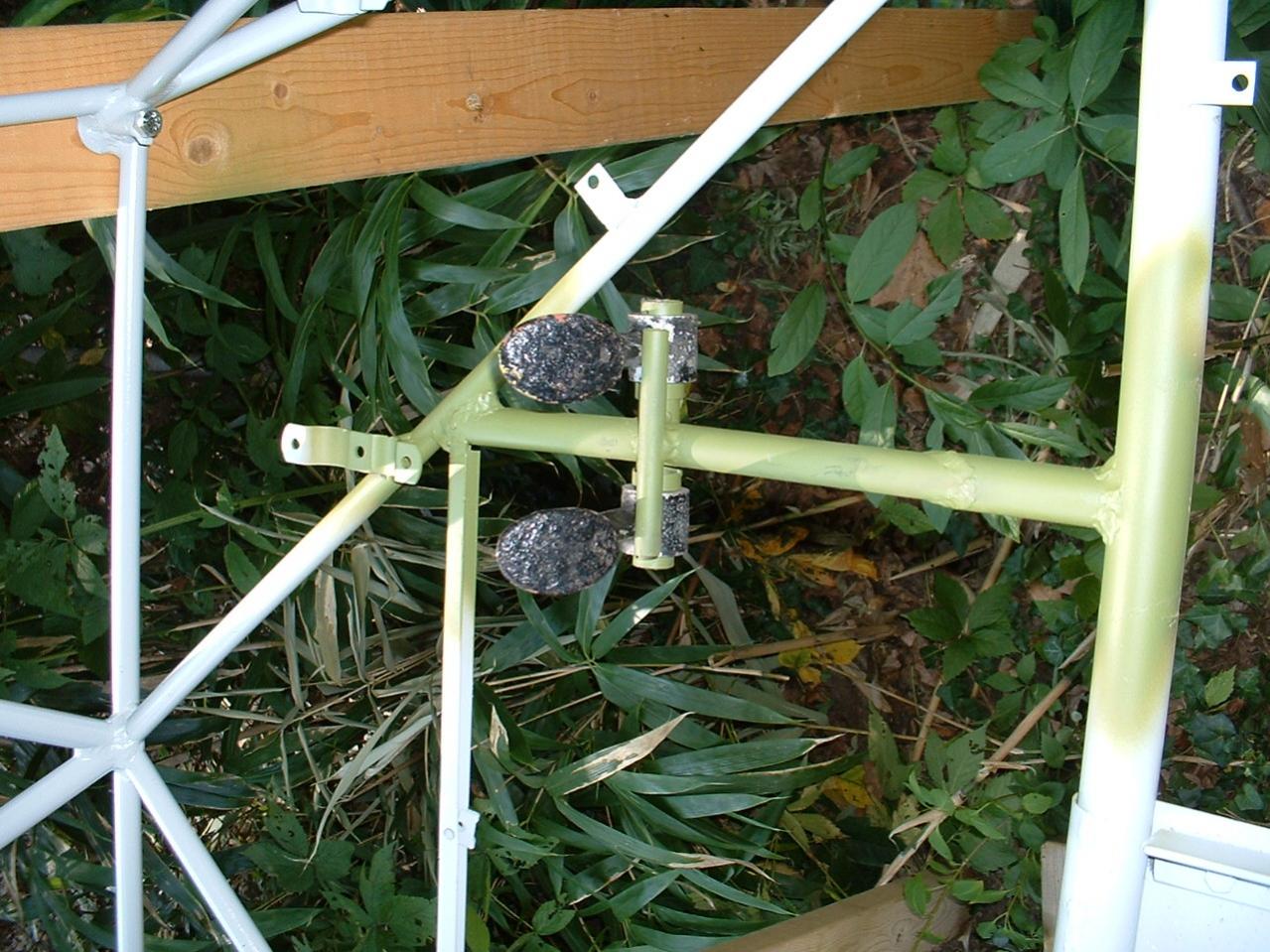

            I did it.
            Here are the results = Mike

                  Nice job Mike!

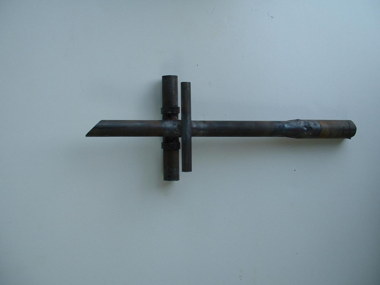

                        Your work looks nice and a lot like the original RH brakes on my 45 with the exception of the two different diameter tubes. On the original the smaller tube connects at both ends with no slip fit tube.

                          Don't know if it will carry any weight with your IA but this is a photo of an original RH brake.
