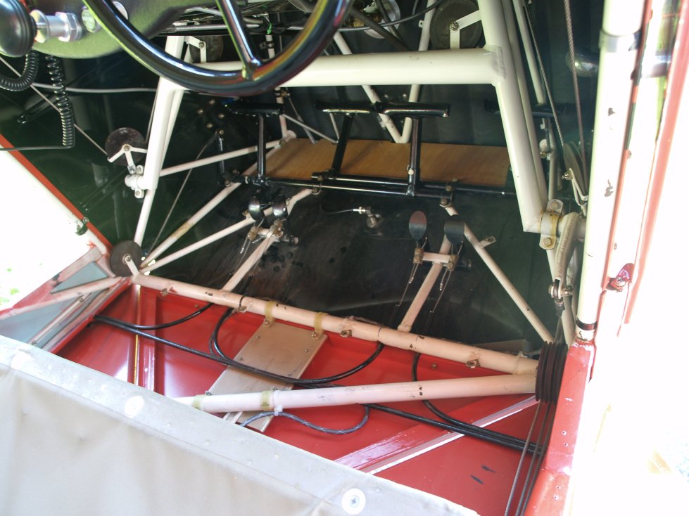

                Anyways, here's a pic of my dual brake installation;

                  is that a sheathing you have covering the brake cables? did you do away with pulleys? - Mike

                    There never were pulleys. Those are tubular fairleads. Very much simpler. More pics here: http://www.candlish.net/taylorcraft/...s/2008_Annual/

                      Obviously Shinn breaks; have to have something to anchor the sheath at either end. Did you install?- Mike

                          Hank - can you think of any downside to welding them in place? the hard part would be making the bend in the long tube, otherwise it looks no more difficult than welding a simple cluster. Economics perhaps? - Mike
                          The bend in the long tube is a non-problem. Actually I need to look at the tube, it may be cut and welded, but either way it shouldn't be hard to make for someone who has done a landing gear and a fin post.
                          The only downside to welding in the parts (from a safety/structural standpoint) is the problem with your brakes being available to someone in the right seat who doesn't know how to use them.
                          The REAL problem is a paper one with the FAA. Make sure whoever is in authority agrees welding them is OK before you put a touch to metal. If you can't get that, just clamp them in like the kits Taylorcraft sold.
