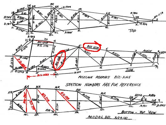

    Specific callouts 1100-1150-1200 gross TCDS A-696
    II - Model BC-65, 2 PCLM, Approved July 22, 1939
    Maximum Weight Landplane: 1100 lb. (S/N 1407 and up are eligible at 1150 lb.)
    III - Model BC12-65 (Army L-2H), 2 PCL-SM, Approved April 7, 1941
    (Same as Model BC-65 except for minor structural changes and added elevator trim tab).
    Maximum Weight Landplane: 1200 lb.
    Serial No. Eligible 2401, 2501, 2503, 2504, 2529 and up and all USAF numbers. Use manufacturers numbers if available.
    Structural differences in the frame are shown in red in the included drawing (Mar 19, 1941 without reference to applicable serial #s).
