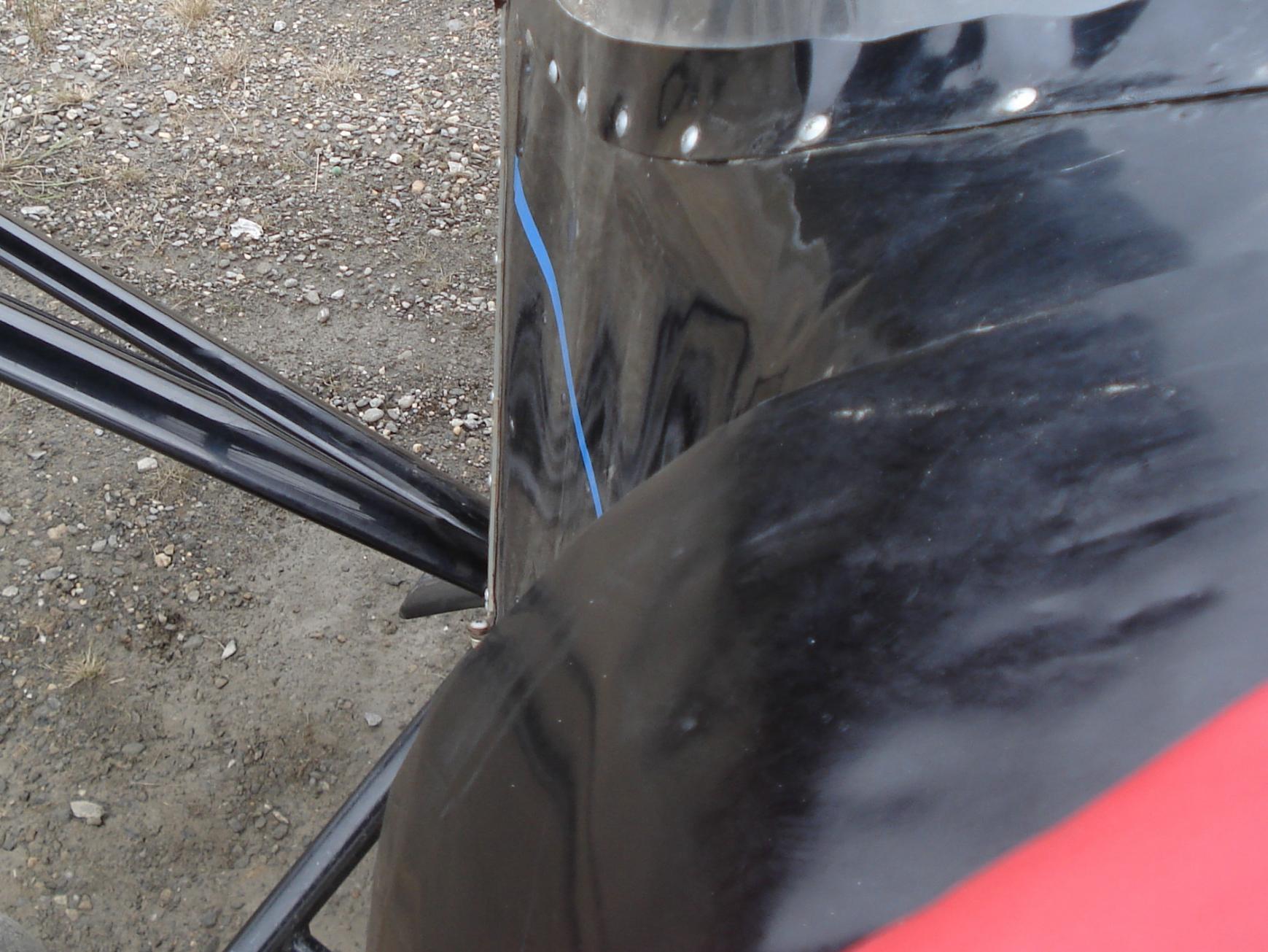

        bc-12d is a postwar model and all those fuselages are the same. There should be nothing needed to widen the cowling. Sounds like some field modification, definitely not factory. Can you take a pic of you boot cowl and cowling?
          Re: Difference in Fuselage
          Here are some pictures of how mine is set up.
          Thanks for any insight.
          Bill

              Bill, to me, that looks like a post-war cowl fitted to a very pre-war firewall.
              What's your serial number...you originally said BC12D...certainly doesn't look like it? I think Mike Jones has a similar cowl setup, and his is a 1939.
              Originally it would have had an open cowl (with eyebrows)?

                  looks like a prewar open style boot cowl with a closed cowl modified to fit. Definite not a factory combination
                  serial number is late '46. What panel does it have? What trim tab does it have? How many ribs in the wings? 13 or 15? stamped or built up style ribs?
                        It's hard to see in the pictures but that big gap there is filled in.

                            Yep , check the ser# on the fuselage; however they are basically all the same. You have a pre-war boot cowl and a homemade engine cowling. If it flys good go for it!!
