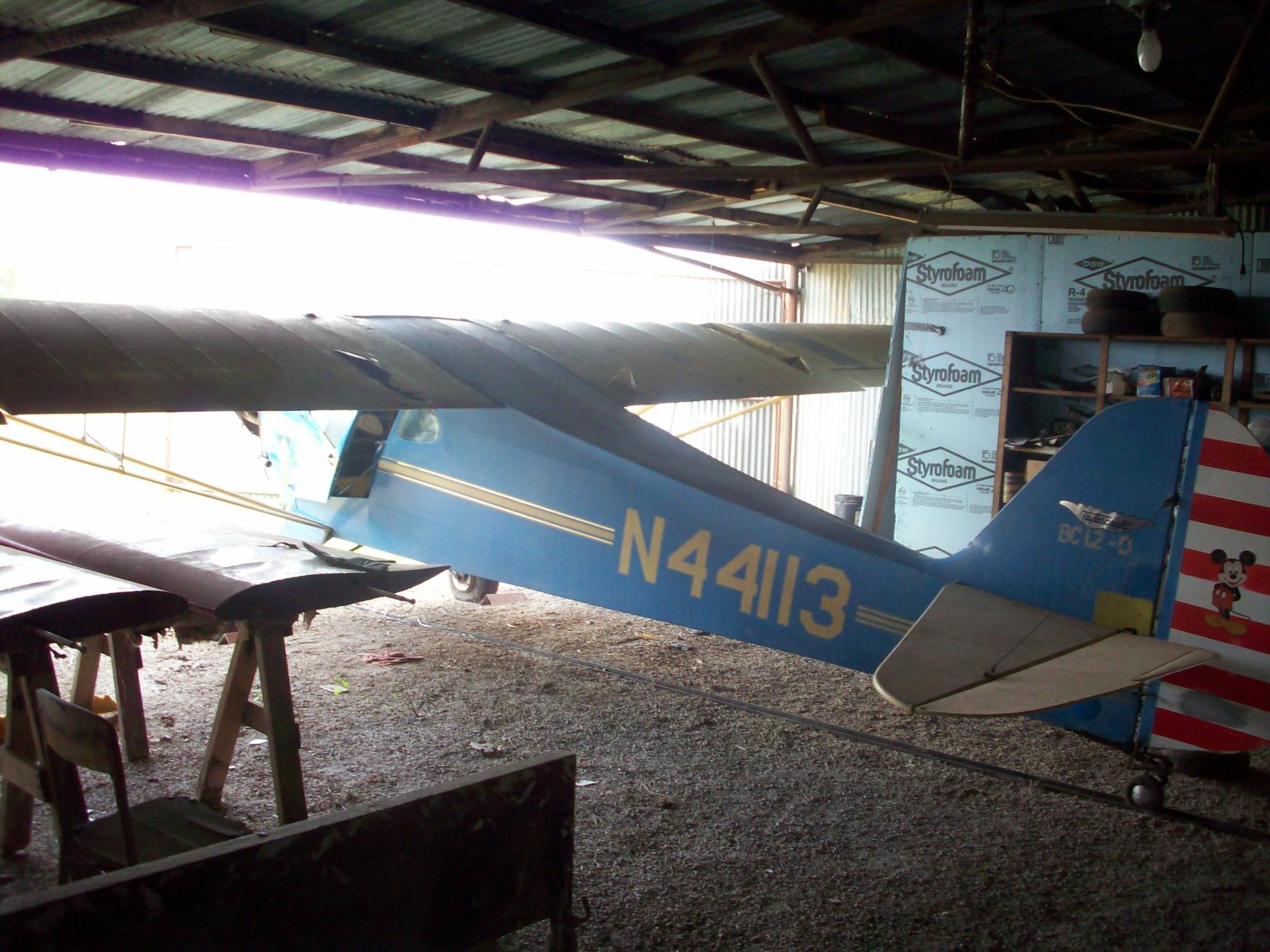

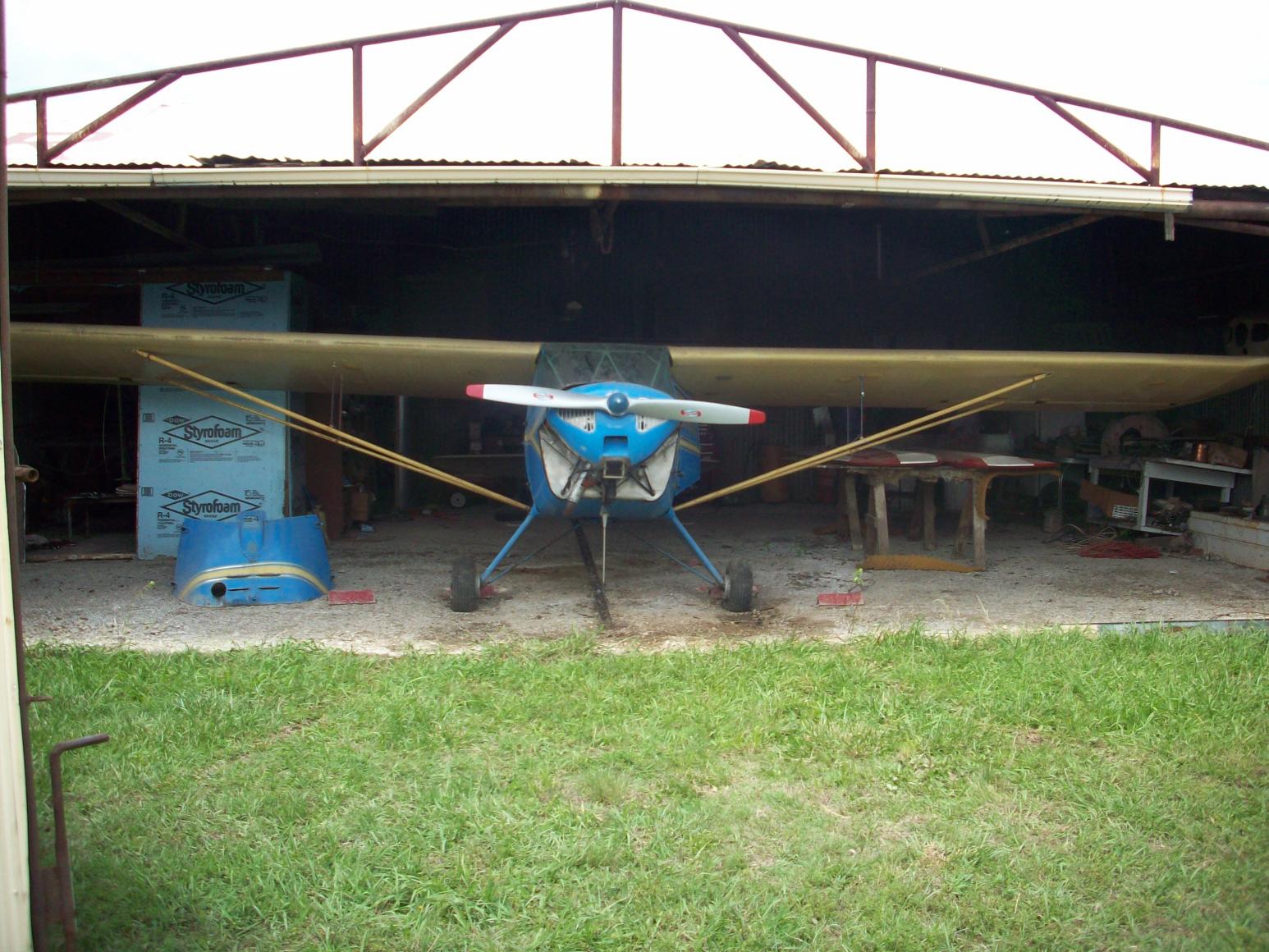

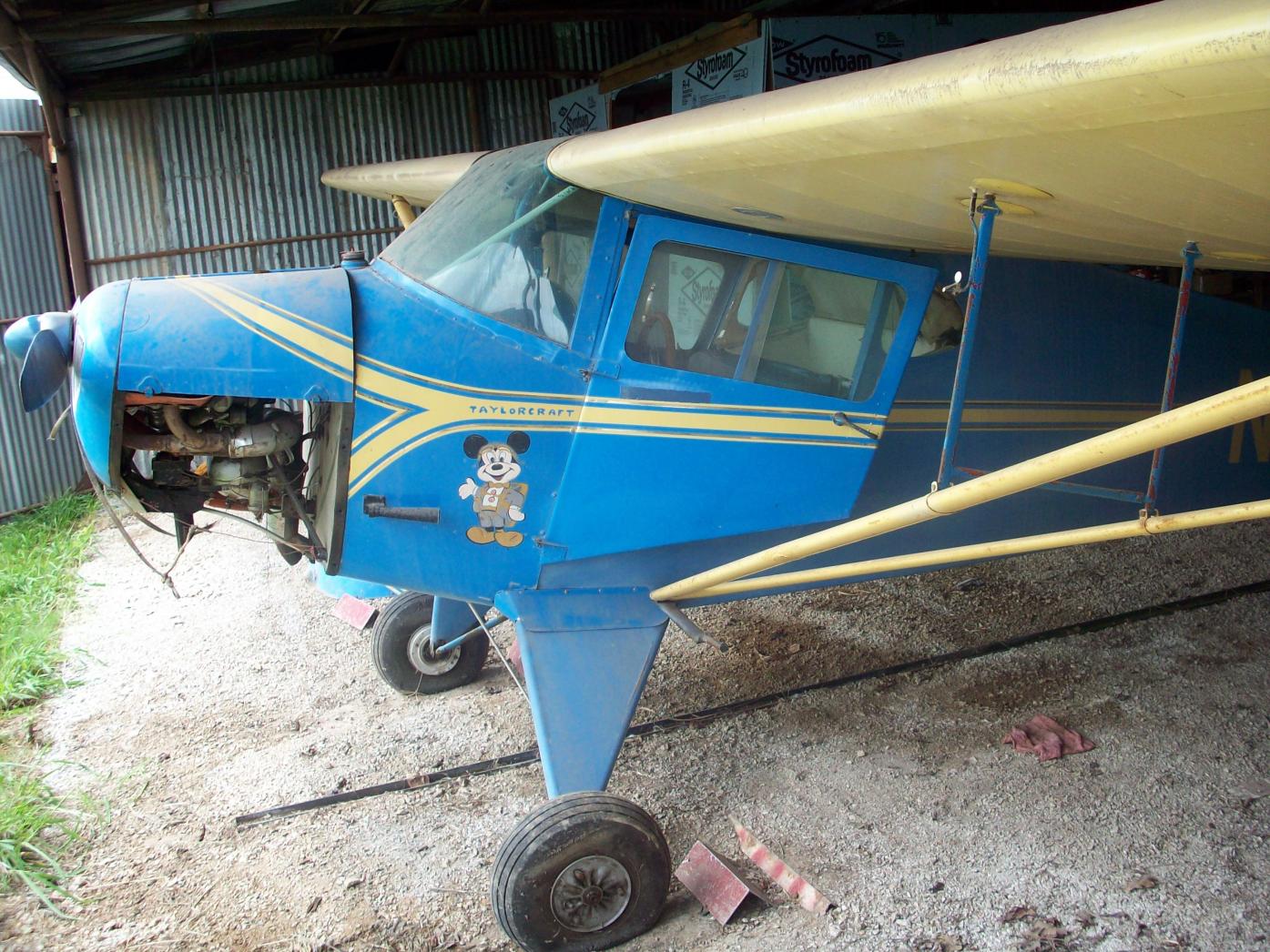

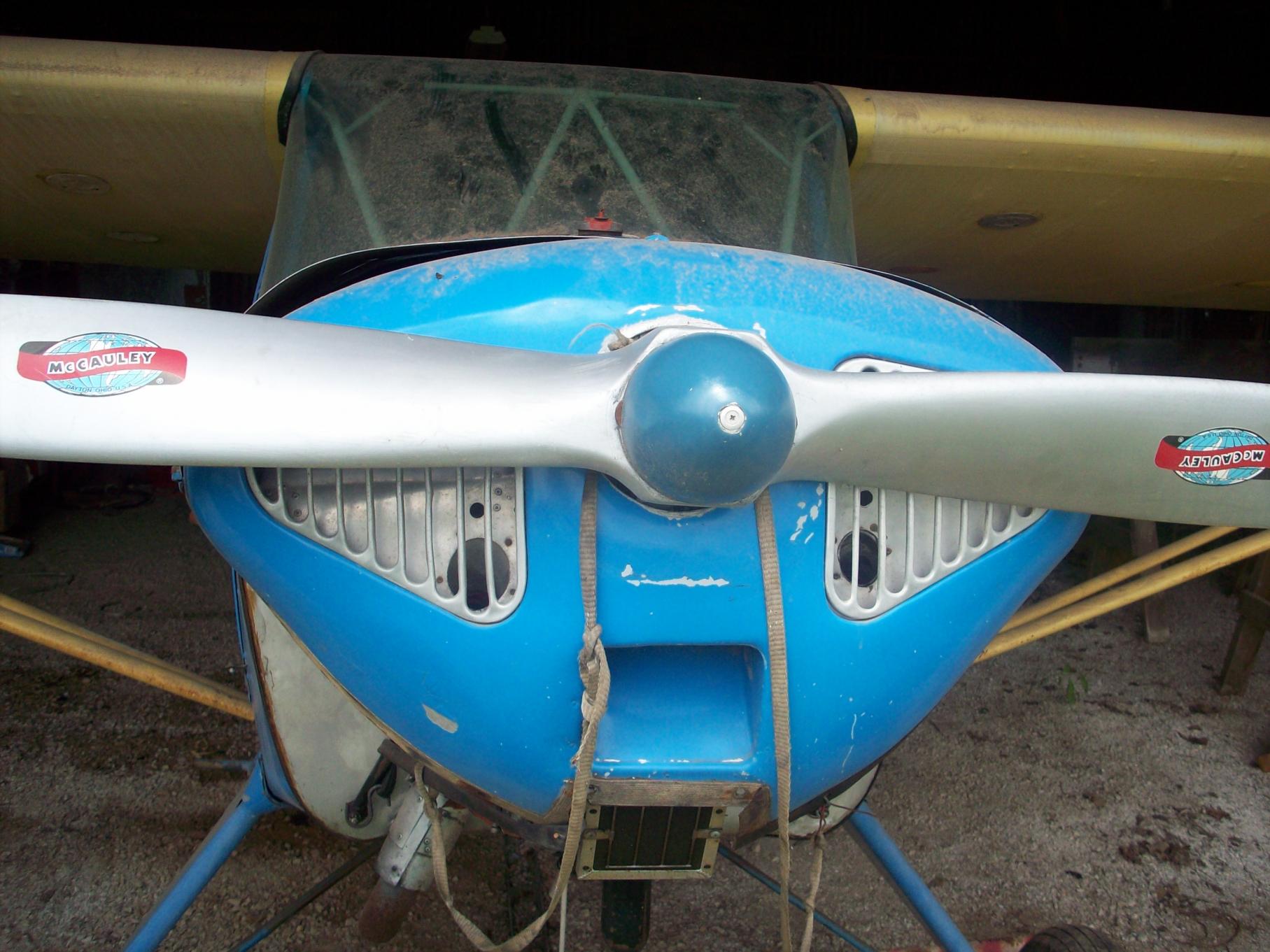

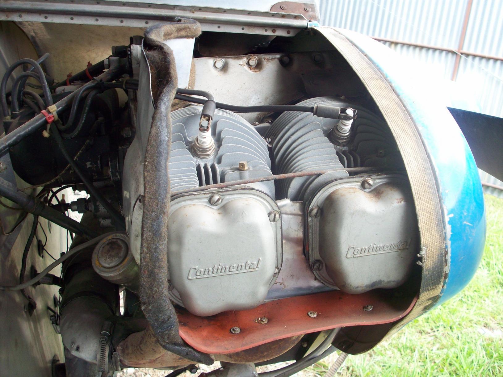

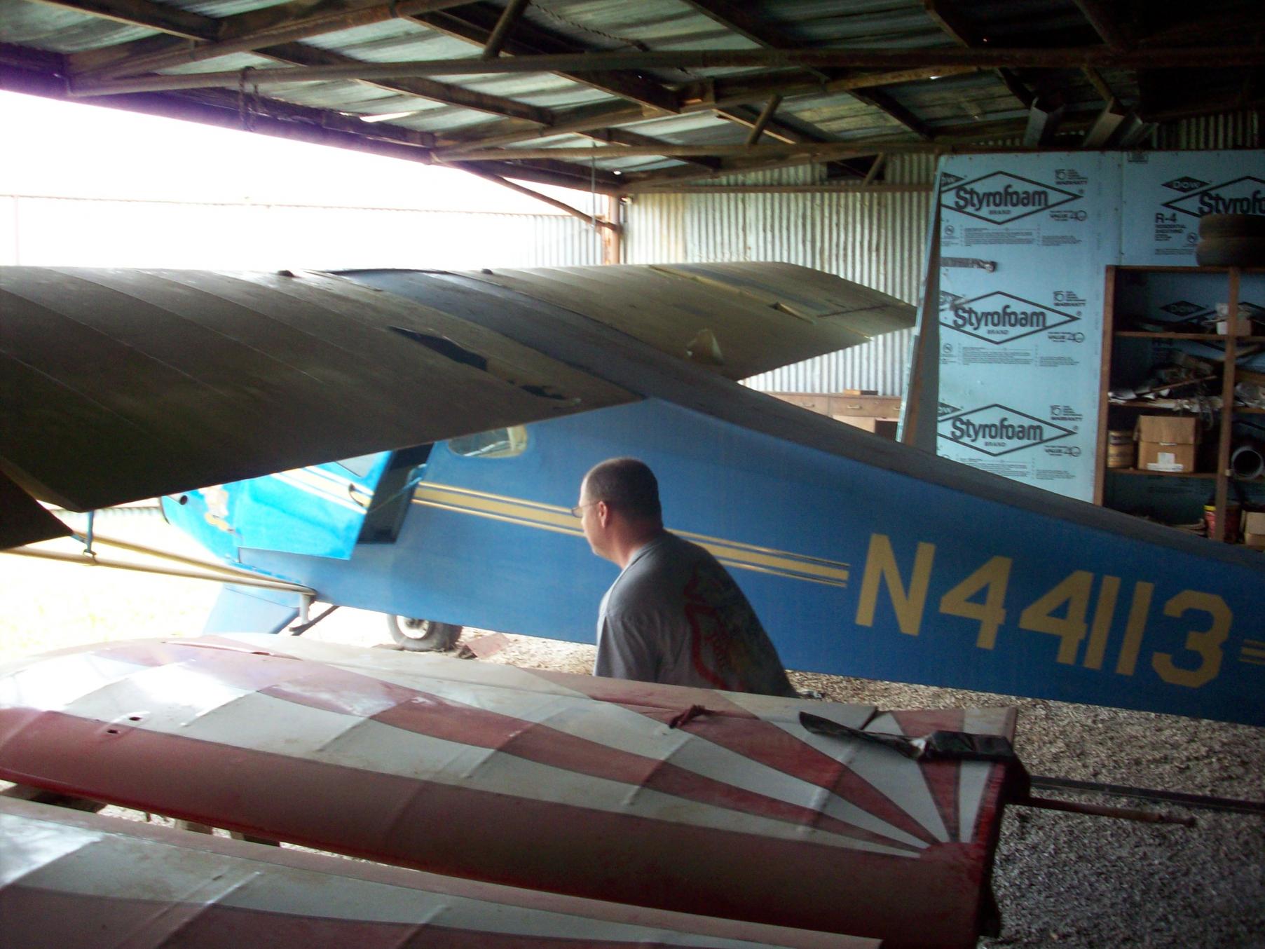

              estate airplane pictures attached
                Re: Estate Sale question
                Looks like a nice project that is complete from the few pictures you thumbnailed. To reiterate a point, the Executor for the estate will have the legal authority to dispose of the aircraft...I would avoid multiple transfers to family members...that just delays the registration process by 90 days for each transaction. The FAA told me up front what they wanted me to do when I purchased my 7AC...the Executor for my transaction was 84 years old, and she didn't want to consult (pay) an attorney to get the Testamentary Letter. When she finally did see her attorney, he had the letter finalized that day after one call to the FAA, and I had my clear registration a few weeks later. Good luck on your negotiations! Doc
