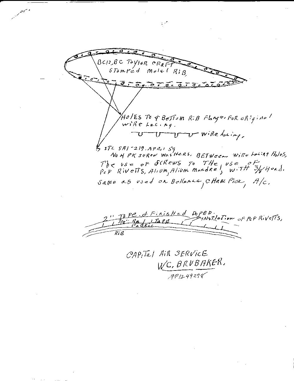

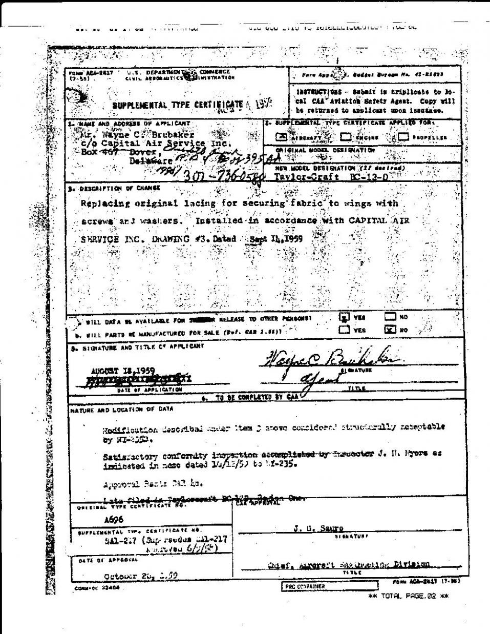

                        There is an old STC for Taylorcrafts to use either PK screws or rivets.
                        Ray

                            You are referring to STC SA1-217. I had previously donated a copy of that STC to the Foundation, but for some reason I don't see it on their website.
                            Here is a copy of the original paperwork I had donated. The STC is actually for using PK screws. But there is also a letter from the FAA stating that they consider the use of pop rivets to be the same as the screws.
                            There is also a copy of a 337 for the pop rivets posted on the Foundation's website under Technical Resources.

                              Does anyone "own" this STC today? I think Capital Air Service is long gone.
                              Ray
