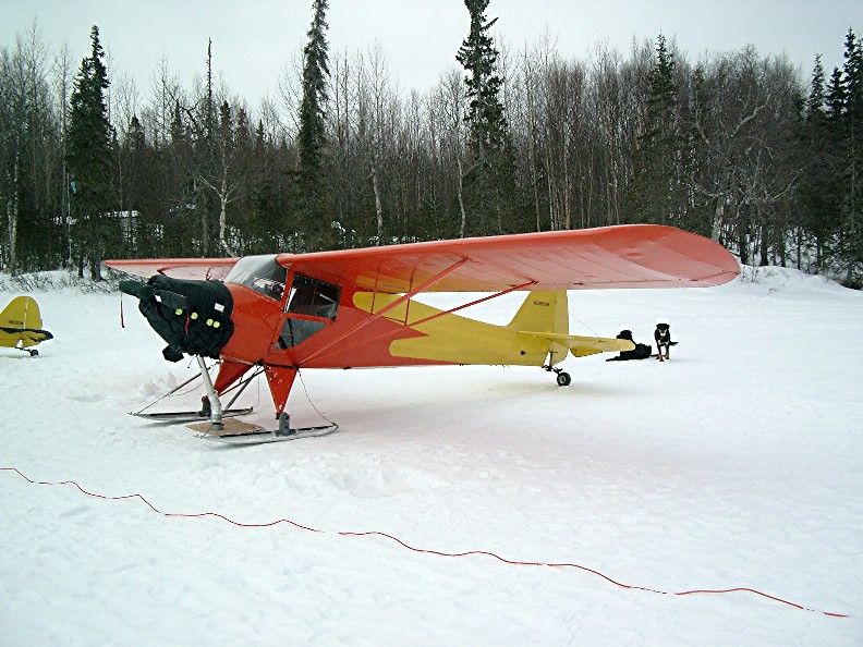

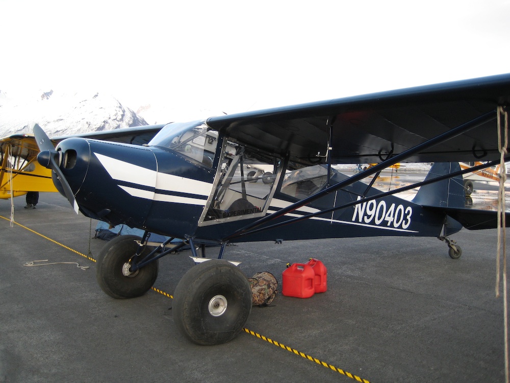

                    Here's a few I've "gleaned", Bill.... not sure who owns what...so if it belongs to you, step up and be recognized!
                      Re: Metal Belly
                      None of those are mine.

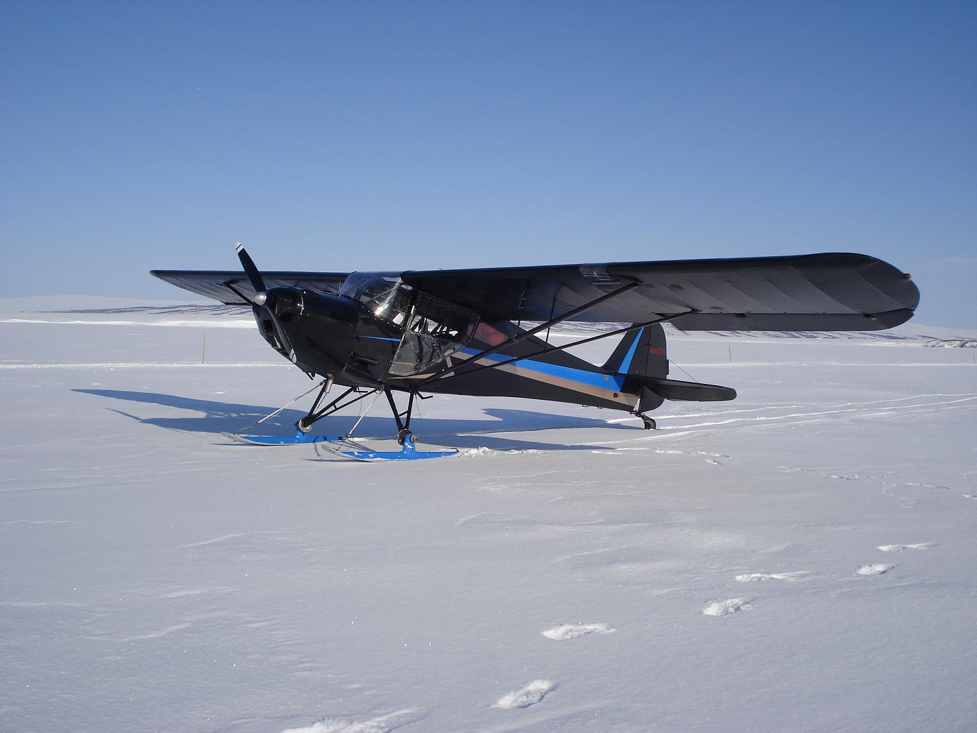

                      Here is my baby.
                        Re: Metal Belly
                        Here is mine...
                        (here's a comment that I made in reference to this item quite a while back:
                        "I think you get more flow of air with the open end like I have. I chose to do it that way for several reasons: Operating on floats involves a lot of moisture and I think the interior of the aft fuselage benefits from the drying effect of the air movement. Also switching back and forth between floats and wheel or ski ops requires easy access to the main bolt between the tailspring and fuselage. The way I did it makes it easy to remove the whole spring and tailwheel assembly quickly. The lack of fabric in the triangular area makes it easy to: 1. remove/inspect the front bolt on the tailspring; 2. inspect the tailpost area and the related longeron welds. Also, dry, blowing snow can find its way into the tiniest openings. If the snow gets inside the aft end of the fuselage, I can see it better through the open slot. And the way I tiedown in the winter, the snow is more apt to finds its way in from the front of the plane and could pack the dead-ended fuselage full. Anyway, that was my reasoning when I covered the plane. Many planes up here have the fuselage open in that triangular area...you will find many that have the "slot" covered with fabric, which should effectively reduce the airflow through the fuselage. It's done both ways...dealer's choice. Basically, we just dress for the cold...if there is any heat available...you just wonder if you're on fire. Lance (Matsuthunder) uses an insulated "curtain" that Velcro's in place, which is as good a way to salvage the heat as you are likely to find."
                        (If a person chooses to cover the "slot" revealed by the "Vee" opening, one can still keep an eye on the welds joining the longerons with the lower end of the tailpost. I've seen that weld crack as the result of operation in very rough conditions.)
