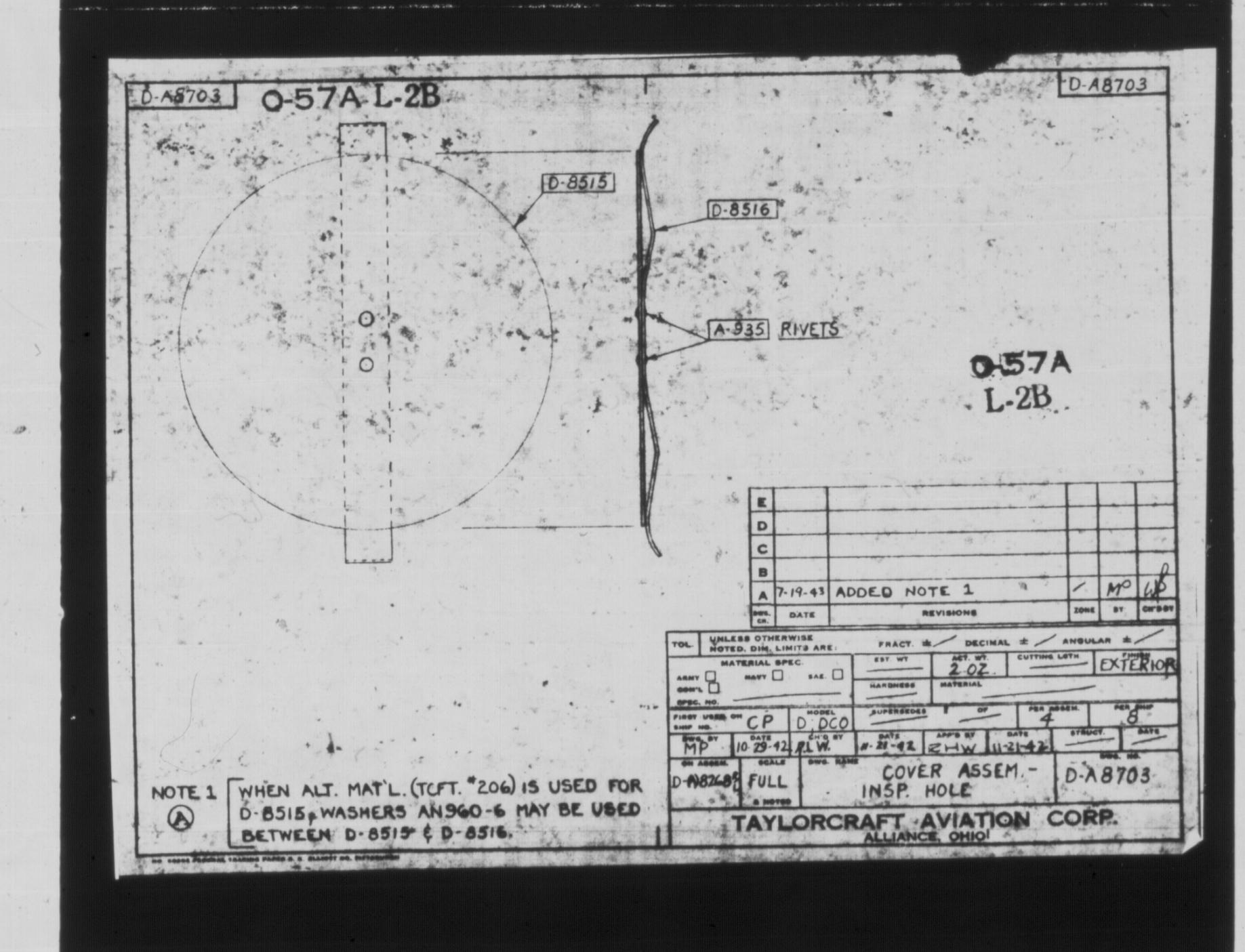

My stack of 30 factory-made inspection hole covers arrived today from my man Antonio at Taylorcraft in Brownsville, along with 60 loose spring straps. These are all nicely pre-drilled, but they'll need riveting. Two parallel straps per cover, one inch apart. Four small vent holes, punched so the dimples go inside, rather than protruding toward the outside. Slight 1/8 inch wide bevel around the perimeter, but otherwise flat. Four and 5/8 inches diameter.
