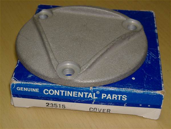

      I believe this is the part you need. The box has the part number. This is an old photo from Ebay, and the price was too high...I ended up making 3/8 ali plates as you infer.

          Hi Tom,
          I heard that Fresno Airparts has a few of the TCM covers to sell.

            Thanks for the replys. I found two sources. Just waiting for reply as to costs.
