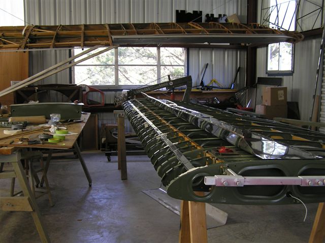

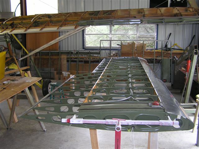

      Wish I had taken more pictures before covering these wings but here are a couple that may help.
      Best of luck,
      Buell

        Buell,
        I am about to instll a new leading edge on my wing. I noticed in you pictures that there seems to be a strip of alluminum running between all the ribs under the leading edge. Is this a mod or original? I am having trouble trying to locate the original screw holes in the ribs. This strip sems to make sense but my wing does not have it.
          Re: stamped butt rib?
          Laz,
          On these F19 wings the factory used L shaped pieces to go between each rib to keep them from bending in between the ribs and glued them in place but some of them had fallen off. I don't think my 41 had anything when it was built either and yours may not have but it does support the leading edges between the ribs and keep them from bending between the ribs if you are using the .016 material and are pretty easy to make. I think it works better and less trouble to just use 2" strips the length of the leading edges. Place them where you want them,mark and bend them 90 degrees 1/2" from each side between the ribs and leave the pieces flat on top of the ribs on each end and centers & tape to hold until the leading edges are in place. Aircraft Spruce has the 016 2024T3 18" wide and I just used the 2" pieces that I trimmed off to make the the leading edges.
