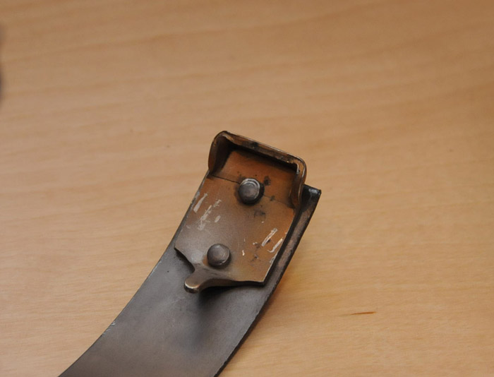

    Another one has a crack completely through one of the steel clips on the end where the rivet goes through. And yet another had a rivet squeezed very poorly. You can see 1/16" air gap between the steel clip and the shoe and the rivet is at a nasty angle to both pieces. The rivet heads are squeezed off to the sides and I am just not happy at all with what I have.

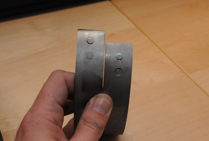

      some pics. See how one of them is 3/8" longer. With that one the wheel can't even be installed.
      A crack in one of the clips where the rivet goes through shown in another photo.
      and a 3rd photo showing drastic size differences between shoes.
      I mean seriously... this is the second set from Skybound. I'm wondering if a 3rd set will finally work or cause me a further 2 week delay with the same result:tdown:
