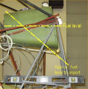

      I tend to agree with Daryl, in that I am not convinced it's an unporting issue. But 30 seconds of googling found this (behaviour of fluid under linear acceleration).
      If one assumed the tank as a cube (and I know it is not), it suggests that 1g of forward acceleration would unport the opening with Bill's 6 gallons (1/2 full). Max acceleration (0-45mph in say 3 seconds) is 0.67g.
      My calculations are not accurate enough for real-time scenarios, so we need a fluid dynamicist to do the calcs for the correct-shaped tank.
      But it invites the question: why does this not happen all the time on all the Taylorcraft in the world, especially with less that 6 gallons?

      I would assume that if the float was going to bind up it would bind up when I ran it up to check the mags ?
      Have you considered the axial movement of the float? In your skidding turn, if the endfloat (excuse the pun) of the float permits it to bind up (perhaps on the lockwire) then this is the time it will happen (quite why this does not manifest itself in a sideslip, I know not).

            Thanks for all the head scratching guys. I cannot imagine the float sticking with a side load on the ground and not doing it during a sideslip (well, forward slip). I do some fairly wild slips on landing like most all of us. Never had an issue.
            My fuel system is fairly normal as I see it.
            The line from the shutoff valve goes through the firewall in the center, turns 90 degrees towards the pilot's side, then 90 degrees down to the gascolator, which is mounted on the very bottom of the firewall near the lower left engine mount tube. (The gascolator is NOT mounted on the welded tab partway up on the engine mount tube... which would put it closer to the !($*^%#$ exhaust.)
            The -6 firesleeved Teflon/stainless hose from the gascolator goes upward and forward, with a slight curve for flexing, to the carburetor. The gascolator is below the carburetor in the 3 point position, and slightly below it in level flight attitude.
            I do not believe this is related to the ignition system at all, I've never had any issues in flight. The mag check shows an even drop of 60-75 each.
            Keep the ideas coming folks, I appreciate it.
