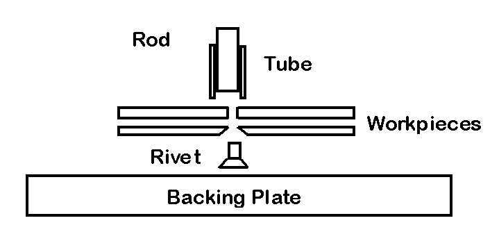

      If they are flush rivets, you can turn the assembly upside down onto a heavy flat steel plate, so the "shop" end of the rivet is sticking up, and use an arbor press, shop press, etc. to squeeze it down.
      Or, you can make a setting tool to use with a hammer.... a piece of steel tubing cut perfectly at 90 degrees and smoothed, and a steel rod that slides inside that tube. Use thick wall tube for a better footprint and press down with the tube so the head of the rivet is firmly in the countersink and the backing plate is keeping it all flush. Whack the rod with the hammer several times and you're set. Make several test pieces to see how many hammer blows it takes. If you want to get REAL fancy use clear plastic tube so you can see the rivet being squashed. See attached sketch.
          Bill - could you please define a few terms.
          "head in the countersink" - no problem - I drilled a dent into my anvil the size of the round rivet head.
          "Backing plate is keeping it all flush". Where does this backing plate come in? - Mike

            Be careful about drilling that "dent"... if it is not real smooth it will mark up your rivet heads and it will be embarrassing and the whole aviation world will come knocking on your door complaining and waving the 43.13 book at you
            Go to anyone who is building an RV kit, or the local airport mechanic, and buy or borrow a small rivet set that fits into one of those hand squeezers. Find them on eBay or through ACS... it's worth the $20 or $40 to have a set. Even without the squeezer you can just drill a 3/16" hole in your steel plate (or an anvil) and make use of it.
            If you HAVE to do it the hard way, get a Dremel tool with one of the spherical metal cutters, but then you have to go in with a polisher or something to make it smooth. Lots of time versus just buying a squeezer set. The AN470 rivet head is not spherical anyway, it has a flat spot.
            The backing plate is the thick steel plate that is underneath the rivet, so when you hit the other end is squashes instead of just flying out of the pieces you are riveting. Technically this is called "back riveting" by the old aerospace guys and RV builders. It is a common and well respected way of getting it done with flush rivets.
                Bill - I built a countersink to hold a rounded rivet head flush. I've been trying your tool and ineveitably, the shop head ends up offset from the original head.
                I think I"m keeping the rivet vertical. Any suggestions as to what to look for? - MIke
