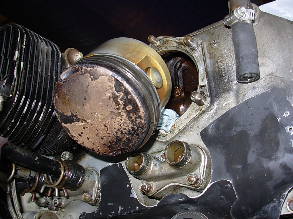

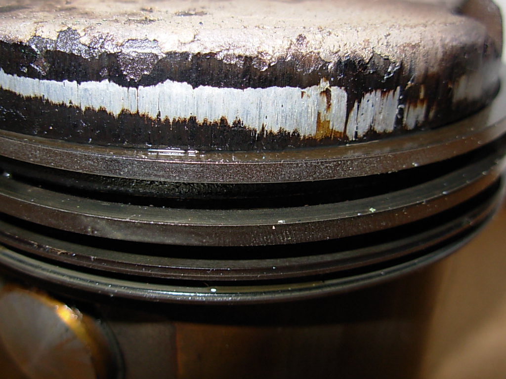

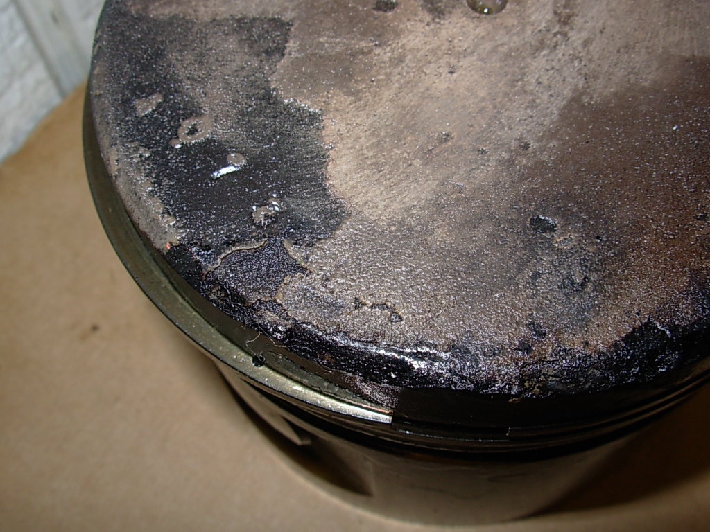

    The pictures you can see here show what a steady diet of 100LL will do to a small engine after only 300 hours. As Mike stated, there is too much carbon build up using 100LL. This problem was discovered last year on our airplane. It started with a stuck valve. My dad insisted we pull a cylinder and take a look, it was not acceptable to him to just free up the valve and keep flying. Boy am I glad I listened to Dad!
    Of the 4 jugs, two had stuck piston rings. You can clearly see the carbon was chipping off the pistons and scoring them. Finding this, we went further and removed the oil tank and found the carbon chips had migrated to the oil pick up screen and it was probably 30% blocked.
    Keep in mind this engine had only 300 hours on it from its last top overhaul. Needless to say it got another one last year. My advice to anyone is get the mogas STC and blend 1 gallon of 100LL and 4 gallons of unleaded together and if you feel like it, 2 ounces of MMO. This will give you the correct lead content for these little engines. Also, please be inquisitive: IF you have a stuck valve, it may be tempting to just get it unstuck and keep flying, but please reconsider, there may be more going on inside your engine than you think.

        Thanks for the pix and info. My overhaul has about 300 hours on it and the top of the pistons are developing a lead/carbon coating similar to your pictures.
        If I am not mistaken an analysis of the nasty looking pinkish stuff, not sure about the white, is lead (probably oxide) not carbon. Needless to say there is quite a a bit of carbon mixed in.
        I think that you will also find that the little chips in the oil screen that look like pinkish cat sand are also lead (oxide.) Appears from some tests that I ran that the oxide is really abrasive.
        There is no auto gas available here that doesn't have ethanol in it, but I am begining to wish that I had not worried about the 5% ethanol, the seals, the hoses and the aluminum tanks about 200 hours ago and just saved my engine.
        Sure glad I don't have a $30,000 Lycoming big bore up front.
