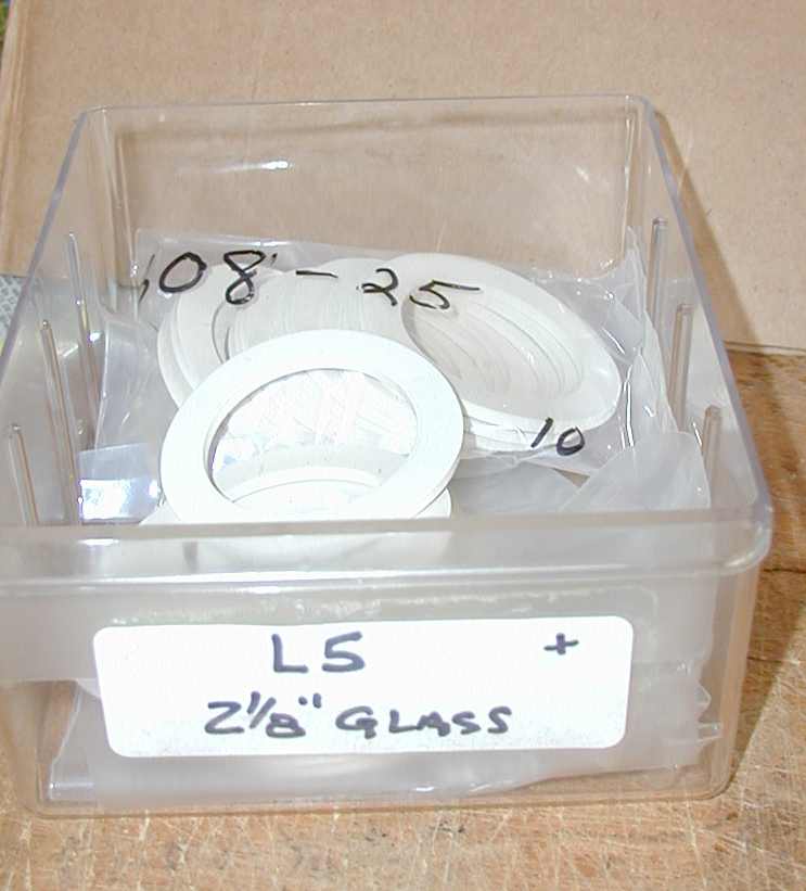

              Re: gascolator problem
              Or, you could go to any reasonably well stocked maintenance shop and buy a 2 1/8" gascolator gasket for about $4.00, or I'll send you one for $3.79 plus shipping...
                John,
                So the gasket must have width, as opposed to an O ring. Now I see the plan. Good discription. Just have to use a gasket with a nominal width and trim the screen to be a little smaller in diameter than the I/D of the can. Then should perform just as you discribe. I believe I have seen a "ledge" in the top cover that will fit well with those dimensions. That is the complete answer I was looking for. Thank you.
                Sounds like I have a few options on material and gasket suppliers.
                Thanks everyone.
                Darryl
