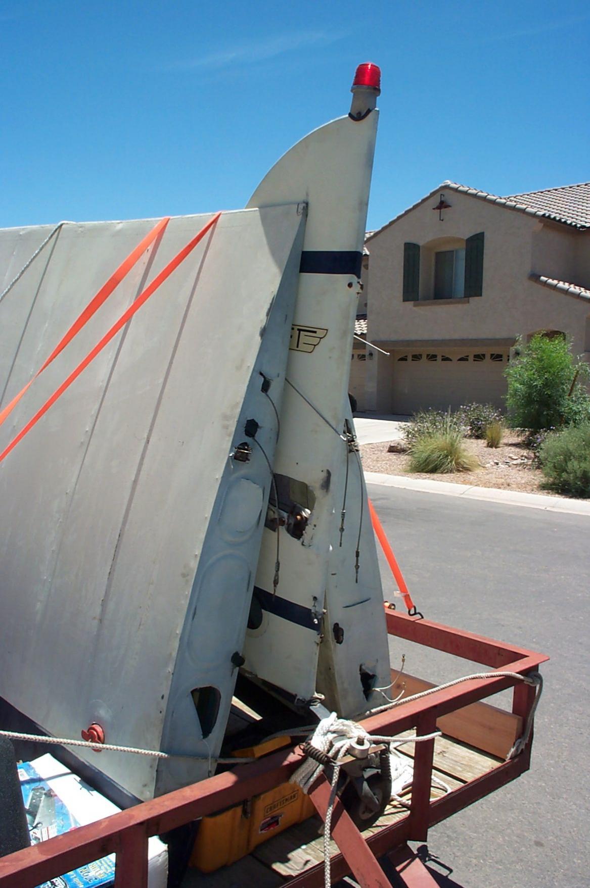

I really didn't intend to start the argument over regs again. My question was one of how guys are complying with the requirement. The automotive flasher is one solution and it's a whole lot cheaper than this, but:
(Click on the picture for the link to Wag Aero's catalog)
But it does only draw 0.6 amps (peak of 1.2? I wonder if that's every time it flashes?)
Thoughts?
(Other than "you're an idiot to fly in the dark" and "old airplanes weren't meant to fly at night," etc!)

That looks like a great beacon if you can get it approved. Very similar the the F-19 in shape.
