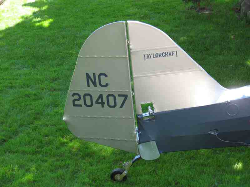

                      I used the Moody masks for my 1938. Cecontie and Dope. Worked great....cheap too. I think the masks were $14 ea.

                        Re: 'TAYLORCRAFT' Logo Variants?? Hank??
                        Yes, I know the location is wrong.....The fuselage will be recovered in a couple years when the Grade A cotton is replaced.
                          Thanks for the pic Mike. That's the drop bottom T logo I was thinking about. What should be different in the location?? 20407 - 20442 = 35 planes apart... Howard
                            Howard,
                            Ask 5 people and you will get 5 different answers as to location. My personal belief is that this was much less of an precise art than modern restorers make it out to be. Going off several pics in Chet's book, the logo is more centered in the vertical fin. There are noteable differences in pictures that can only be assumed to be factory pics or original markings. Wish I had the book in front of me right now..... but I don't.
