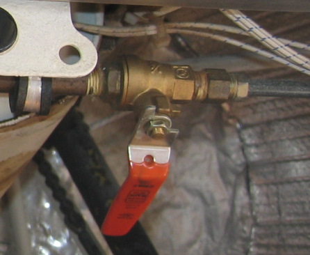

                    I'm looking at replacing my valves because my assumption was that existing were not certified. See pictures. It's possible the left one is but I'd say it's likely the right one isn't. Can anyone tell from the photos if they are? Is there a certified valve available?

                      Left picture is of the original equipment valve. The right one is a hardware store valve. I have several of the hardware store type laying around and have seen lots of them on old planes (not mine). The hardware store ones I have are all metal and good for use with fuel (the valves are even good with alcohol!). They don't scream "NON AIRCRAFT!!!" so loud of you ditch the plastic dipped offset handle. If it had an antique handle like the original one I doubt anyone would ever notice.
                      I am more worried by the teflon tape. NO TEFLON TAPE ON FUEL FITTINGS!!!!!!!
                      By the way, the valves Taylorcraft used in the 40s were sold in hardware stores. Go figure!

                        Red handle valve is not an original valve, I do not recognize here it comes from.
                        The other one is an original valve, its ok.
