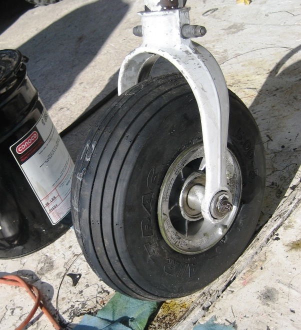

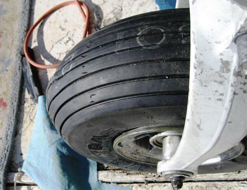

    Here is a pic from a C-172 where the carb dripped auto fuel onto a brand new tire, notice how the tire bulged and the tread swelled. I wound up replacing the tire. Needless to say the owner was PISSED! This is just an FYI for those of you like me that use mogas. Tim

    I know this should not be a question, but was that with or without ethanol? I had to ask. What state?
    DC
      Re: Mogas problem.....
      Ogden UT, and I didnt test for Alcohol, I dont think they use it because of the altitude...4500 msl
        Avgas will do that as well. Given time it will shrink back down, but I would replace it too. Tom
          You sure that's from the fuel? With the degree of distortion makes me wonder if the tire may be defective. (such as a ply separation)...
            Its from the gas, it was dripping out of the carb air box and the tire went soft and swelled where it got fuel on it. It sat for a week with the fuel off and was still swelled pretty bad. Tim
              How long and how much gas leaked on the tire?Also,as Tom said,100LL will do the same thing only it will do it quicker.....fix the fuel leak and you will not have that problem. I admitt that if you have an airplane that only flies a few hours a year it is better to have 100LL in the tanks because it will not go stale or varnish.However if he's running an 0300 cont and flying it regular he will much rather pay the price for a tire over the cost of cylinders,fouled plus,burnt or sticky valves,and lead build up. We have a C-170B with an 0300A that runs mostly on 100LL and in the last 300 hours over the past 4 years we have pulled 4 cylinders because of lead build up on the valves and one burnt valve. In the other hanger we have a 1959 C-172 with almost 700smoh that was done in 1997. It rarely gets any 100LL(almost always 87oct) and has never fouled a plug,never had a cylinder problem,and runs twice as good as the C-170.The plugs from the C-172 are always clean and the oil filter never shows any carbon,dirt,or sludge what so ever between 50 hour changes. The C-170 with the same oil filter system always has dirty,black oil,lots of carbon,and the plugs are always carboned over after 50 hours. Do your research,these old low compression continentals were designed for 73-80 octane leaded or unleaded gas. Way back then when they said leaded it was much less then today 100LL.....less by almost 4 TIMES what they used back in the 1940's,50's,& 60's. That's right,todays 100LL has nearly 4 times the lead that was available back in the day when these engine were built.
