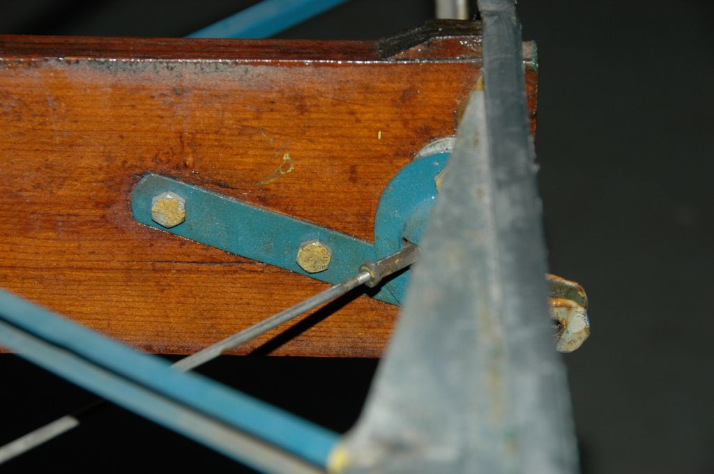

    Recovering and discovered longitudinal split about 1/3 down from top and extends 7 inches from butt end inboard. Lowest bolt for wing attach fitting below split, center bolt perhaps thru split and upper bolt is above. See photo (wing upside down).

          Umm, am I missing something, or in this case is his spar.......like the end of the spar being milled down and plywood reinforcements being glued and nailed on? Looks like one piece of spar wood from that picture. If that's the case, no wonder it cracked. And is it my imagination or is the left most strap bolt been so overtightened to the point the strap looks like it's almost flush with the wood?

            Your correct about the left fitting bolt in the pic,it is overtightened and that is one of the reasons they put the plywood doubler on the butt end of the spar. The other reason is to help prevent the spar from cracking at the butt end....:clue?::. Anyway,you can splice the spar but when you splice the new butt end on MAKE SURE you install the reinforcement doublers. Also,make sure you have the doublers at the wing strut attach fittings at the middle of the spar.

              If whoever rebuilt that wing did the other one you need to take them both apart.It's not that expensive for materials and with some extra time you can have virtually a new set of wings. Aircraft Spruce has the spar wood,plywood for doublers,@ hardware.

                I agree with the others, but I'd never waste the time to splice it.... that's more work than just replacing (in my opinion). I'd also pull fittings on the other 3 and really give them a once over, as stated before. If any of them don't have the plywood reinforcing plates, they'd be a wall hanging pattern in my shop.

                    Thank you to all. Your knowledge is incredibly valuable. Indeed, I am not fussing around and will order both the rear spar and front as neither have the doublers. It seems the split spar wing is prewar and other is postwar with doublers. But my A&P and I have a question. On the postwar wing, the last 6 inches of the butt end was planed from 5/8th inch to 4/8th (1/2 in) to accomodate the two 1/16th inch doublers (to equal the full 5/8th in thickness). Is this proper proceedure? Seems it would significantly weaken the beam strength.

                      If you talking about where the doublers are and it was planned to the same thickness as the rest or the spar then that is correct. Are you using pre-war or If you are using stamped ribs and the but rib is nailed to the spar butt you might consider making an end cap from the plywood used for the doublers. A common problem for the post war is that the nails wont hold to the end grain the nails work loose-the hole gets enlarged and moisture rots the end grain around the nails. Sure glad you are consensus enough to make sure the wings are done right--there is an earlier post about a bad spar because it had been neglected. It had been inspected for years WITHOUT having the inspection holes cut-full of bird and mouse stuff, and the guy was doing aerobatics in it! Those guys should have known better or someone should have told them--the guy that was flying that plane should have known better also.

                            I got permission for a glue repair of a split in the rear spar through a bolt-hole, as your photo suggests, at the butt end, but mine were the ply-reinforced type, and the spar was not overly-compressed by the bolts.
