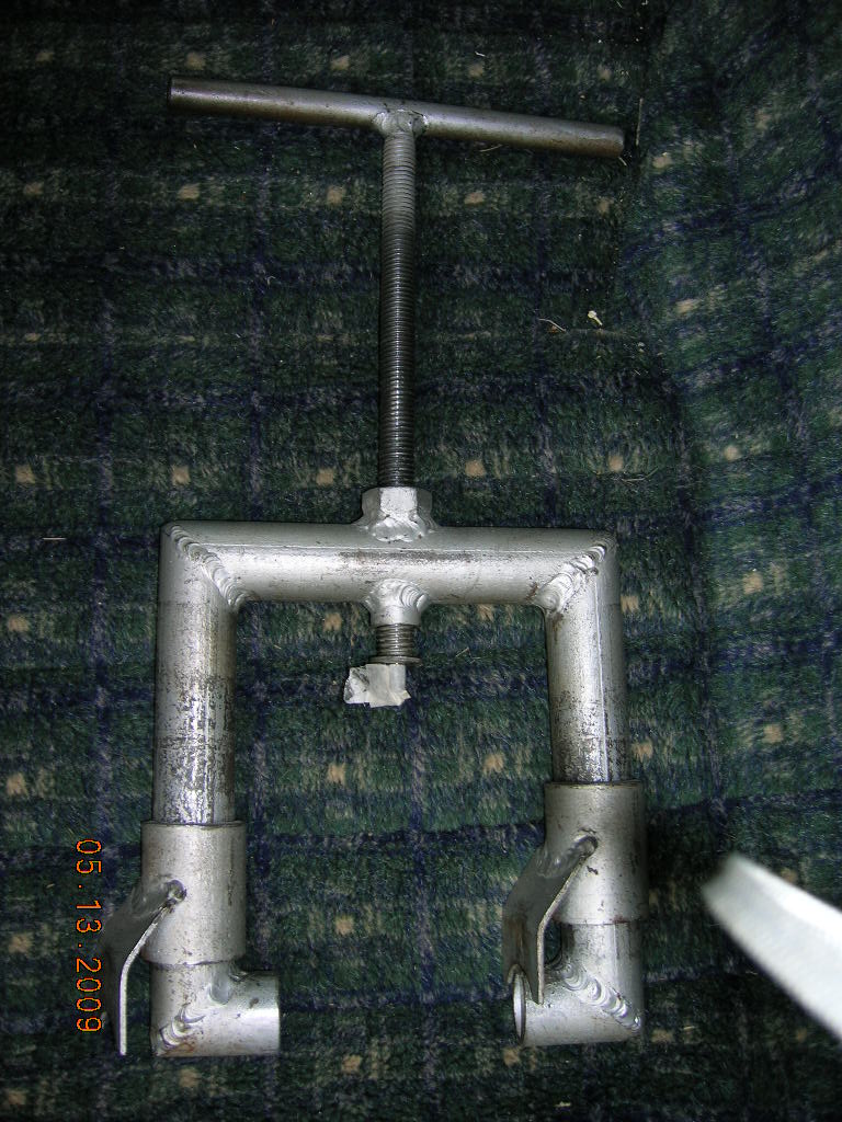

        I thought the suggestion to use a third bungee was a swell idea right up to the point where I couldn't get it on over the other two. I employed the Tcraft-specific tool to no avail, amazed that the cord could pass through the small space between the tool and trunion as it came off, not to mention the resounding thump when it did so. After 3 tries and a little scarification of the cord threads, it seemed prudent to quit while I was ahead. Additional collateral damage noted was cracked paint on the bottom of the fuselage just aft of the bungee hole, presumably from one of the recoils. Good thing the dog wasn't laying down there.
        Having figured on the fifteen minute version mentioned above, I wonder what I'm missing. The attempt was made with the plane sitting normally on its gear - should weight be taken off of it to make for less stretch?

            Hi Mike,
            I put a third one on and don't recall taking any special measures other that working the 3rd cord towards the center of the trunion as far as possible.
            What brand is your tool? One of mine?

              It's one of the original Tcraft tools, according to the owner, who I borrowed it from. It has sleeves on each side to hold cord on until time to transfer to trunion, then are slid out of the way. Did I mention I tried using the regular size (9010HD) cord? Is that what you use, or a longer one?

                  Mike,
                  I used a 9010HD but my tool does not leave a gap for it pull thru.
                  Its your tool that's the problem.
                    Re: adding the 3rd bungee
                    I agree - here's a picture, with one guard off and one on. With the right size plug in each end to eliminate the gap, I think it will work OK. Maybe later I'll even be brave enough to try it!
                    MV
                      Use two people and tip the top over a bit to close gap on top prior to "flipping" cord off.
