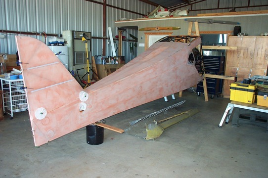

Hi Mark,
Man, You have come a long way since I saw it last! Looks like Doc is going to have a really nice T/craft.:bravo: Some day you,Doc and some of us are going to have to plan a Fly-in-----Hummm breakfast at Fredricksburg?
Buell
Yes Rob, we unabashedly copied your hat shelf. A good idea like yours ought to be repeated.
I'm sure we deviated on some of the details, but it looks really sharp.

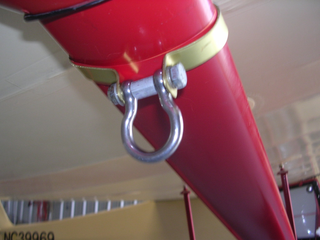

Remember, DON'T tie to the ring!!! It is only there to keep the rope from sliding down the strut (every inch down the strut increases the bending load on the strut, and we all know they are EXPENSIVE!)
Run the rope through the the ring, tie to the strut as close to the upper fitting as possible and back through the ring.
