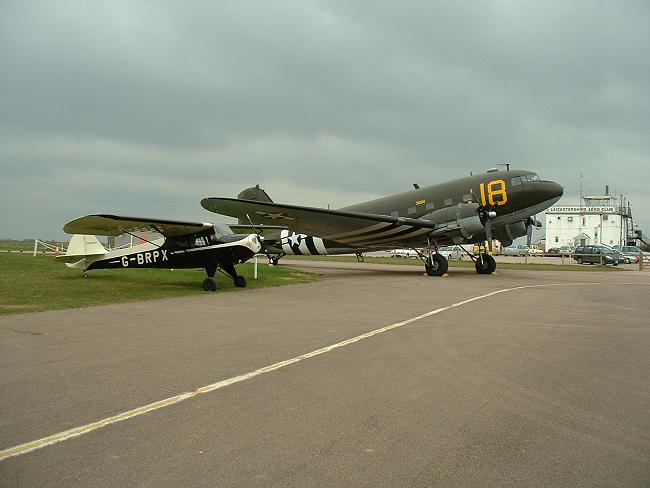

          Good to see you here, Greg.
          Greg is another old friend of the Email list. I bought a lovely wing tank from him about eight years ago; it now resides inside the starbord wing of G-BRPX, which is why she sports a D-Day stripe on that wing.

            The picture made me remember how upset I was with myself. At an airshow in Paso Robles Ca. many years ago my Taylorcraft was parked next to a DC 3 A college student was sketching the scene, almost like the picture. She asked for permission, showed me the finished sketch and I was too dumb to ask her to sell or give me a copy. Thanks for the memory.
