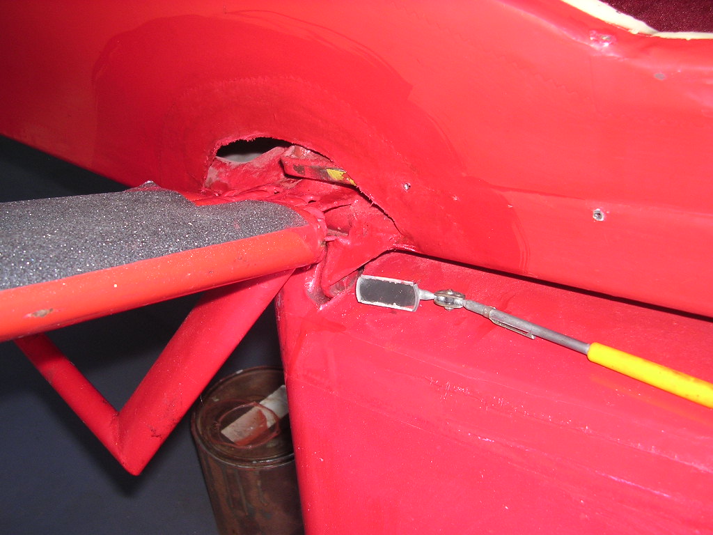

              I used a 1/4 inch borescope, found it interesting, no apparent rust. I cut a small extension mirror to a 1/4 width. Using a flashlight and with the struts removed I could see into the attachment. See attached picture
