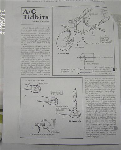

        I have a drawing on a really good way to repair worn holes on the rudder control arm and how to make it last longer. If anyone is interested I would be glad to mail a copy or I can take a picture and e-mail it.

          Re: Wanted Rudder Arm
          How about posting it?

                  This from an old Taylorcraft newsletter
