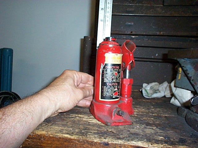

        Dave, congrats. How did you support the wings while the struts were off? I also would like to know how to raise my plane to change tires or work on the brakes? Thanks Don

          Buy a cheap 2 ton hydraulic jack. First go measure from the inside of the wheel frm the bottom of the cabane strut to the ground then only buy a jack that is shorter than that. I found one for under $10.

                my jack is 6-1/8" high
                this one is 6-1/2" => http://www.harborfreight.com/cpi/cta...emnumber=47758
                don't know this height looks promising though => http://www.amazon.com/dp/B000VQGPUW/...W&linkCode=asn
                this says its 6" => http://www.amazon.com/dp/B000RGRWE4/...4&linkCode=asn
