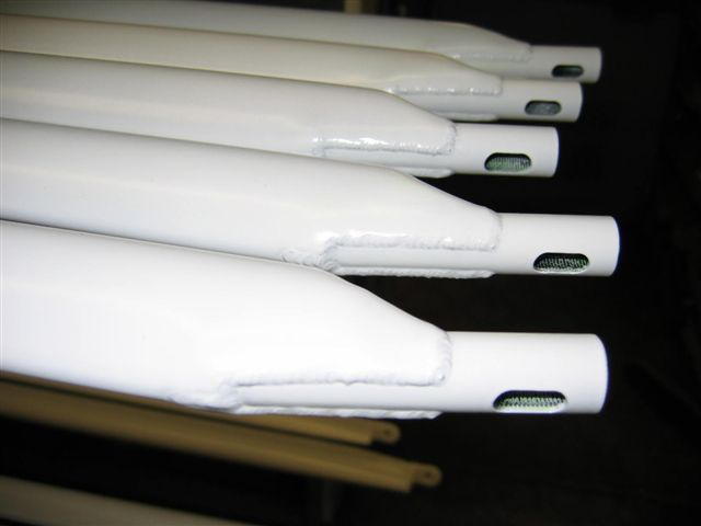

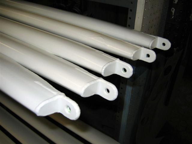

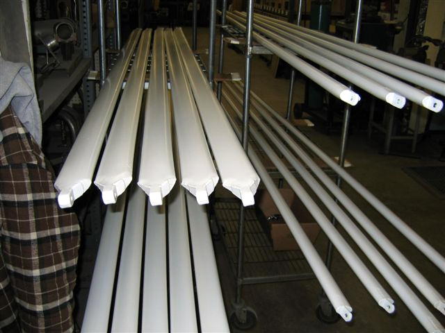

                      Tom sent some pictures of Wag Aero struts so I thought I would post them.
                      Buell Powell TF#476
                      1941 BC12-65 NC29748
                      1946 Fairchild 24 NC81330
                      • Re: A list of lift strut suppliers (updated 12 Dec 2007)
                        Thanks Buell.
                        Any comments on the pix guys?
