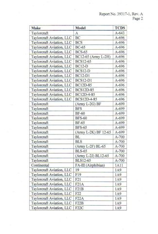

        This will probably seem like a stupid question but my Dad has an L2-B which is a DCO 65. Does the AD apply to it, I ony see A, B, and F models listed. If it doesn't apply can somebody tell me why?
        Thanks
            Thanks
            Dave, read thru the AD to find the answer. Dave.

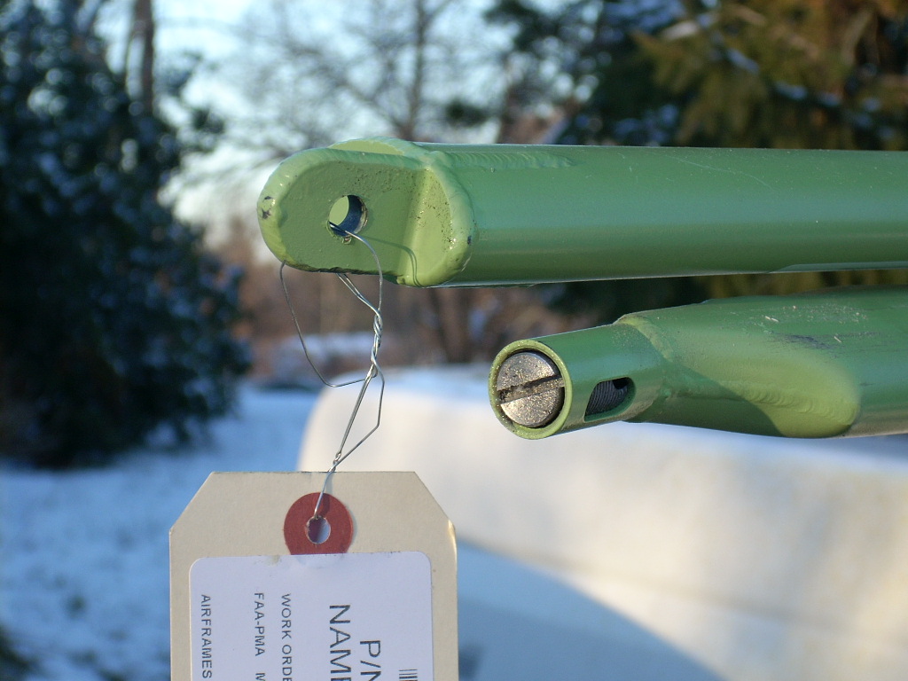

                3) Airfames Inc about $1800* => http://www.supercubs.com/fab_manufacturing.html
                * base strut includes jury strut clamps too
                Appears that Airframes Inc is a reality now and you can order struts from them.

                        My Airframes, Inc. PMA'd struts will be delivered this month.
                        The daughter will be delivered in Feb.

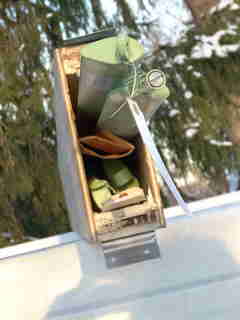

                          Early x-mas present from the far north (well AK) arrived today. Came with an STC. Will dig into the paperwork tonight for more info. $2075. delivered to mid MD.
