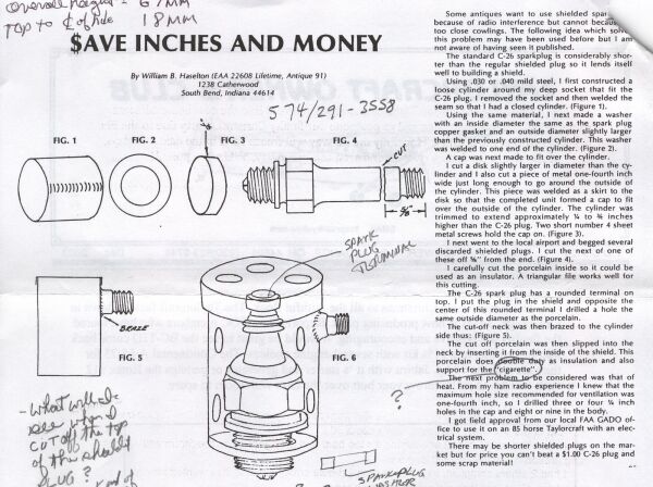

                I think I will go with the Aerocoupe Cups. I posted drawings some time back for a home made cup that I have been told works well. Made from small metal cans you make up at home.
                  Re: Excellent Experience with Champion!
                  Hank would you know what thread that was on? I just did a search with no luck on the drawings. If given the time I can duplicate anything and keeping my cowl "hump free" is one thing I would like to do. :rolleyes2:
                      See attached - MIke

                        That was the article I started with. There were a couple of problems with that design that are easy to address. First I added in a small cross hole along the edge of the cap (like from the 12 o’clock position to the 3 o’clock position) that you can run a cotter key through to hold the cap on (it WILL pop off!). Second, you MUST make sure there is enough clearance between the top of the plug and the cap. If it is too close the spark will jump from the plug lead to the cap and the engine will run REALLY rough! I don't know if there will be problems with the washer bottom replacing the copper washer under the plug over time. It is the same way the Aerocoup cups work and there have been no complaints about them since the 30s or 40s but I think my cups are aluminum, not steel. The Aerocoup cups are getting REALLY old and if someone wanted to make these things up in a batch I'm sure there are a lot of people who would want them. I also think they could be made from thinner stock and silver soldered together. The shielding doesn't come from the thickness, it comes from the grounding and keeping the cooling holes small. I wonder if those small tomatoe paste cans would work?
