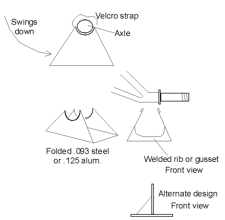

                    Darren you might be barking up the wrong tree IMHO. What could someone use the stand in your photos for? You can't change a tire with it because the stand has to come off before you put the wheel on.
                    Give me a couple of minutes and I'll make up a sketch of what I thought might be a better wheel stand...

                        Here's the idea I had for a quick and cheap jackstand for a light plane that would allow changing a tire without a jack, even in the field somewhere. This can be made very light with Titanium or Aluminum.... or very inexpensively with steel.

                            Bill... your design IMHO - from a manufacturing standpoint - is flawed.
                            1) alum in that thickness & design would not be sufficient for side loads / bumps into the wing (what my stand is designed for while wheel is removed & so you can remove both wheels at one time - get your hands greasy once, clean up, and then reassemble)
                            2) ease of manufacturing - it would require specialty dies for bending and or a one-stroke double bend
                            3) design requires more welding / fitting than necessary for the job at hand
                            4) loads in the vertical would put undue pressure (psi) on the paint / axle (no felt would survive)
                            5) have you checked alum prices lately in thickness that would be remotely acceptable?
                            Anyhoo - always fun to see everyone's ideas - :yahoo:
